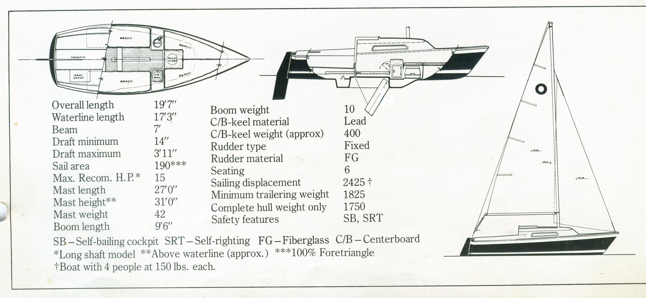

1974 specs.JPG O'DAY 20_specs_76-78.JPG 1974 specs.JPG The Standard figure for sail area on the 1976-78 O'DAY 20 is 190 SqFt, MARINER has 185 SqFt., So, the 20 actually has slightly more sail area than the Mariner. I think your figures showing less must have been referring to the 1973-75 O'DAY 20 which had a masthead-rig with a shorter mast than the later Fractionally rigged 20s. Anyway, I would think the 20 would be more or less similar in sailing performance to the Mariner, with more ballast the 20 may be more stable, but still would seem to perform close to the Mariner.
