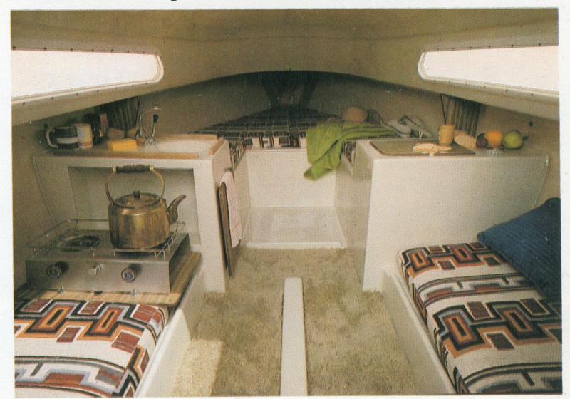

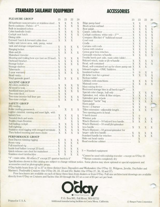

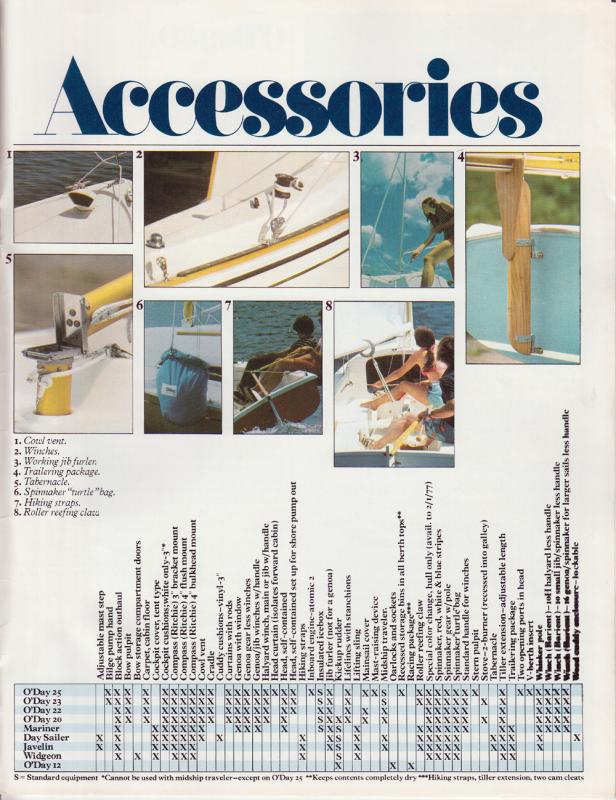

The stove was an option I believe on the 20. It is listed in the 1977 brochure as such, as well as in 1978.
I don't know what exact model was sold as that option, it appears to be a 2-burner pressurized alcohol model. I would think most 1 or 2-burner non-pressurized stoves would fit, the ORIGO that Joe mensions is one (but $$) however, other brands are very similar and less $.
I think your best bet might be to call Rudy at D&R Marine (508) 644-3001, he was the parts dept manager at O'DAY and should know what stove was offered.

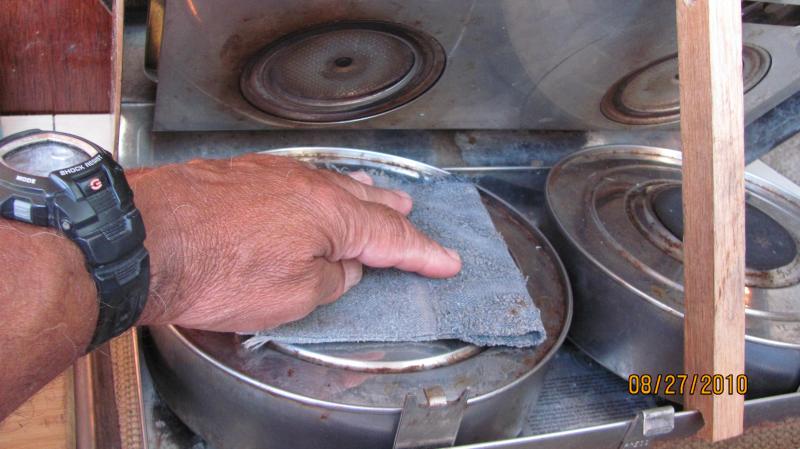

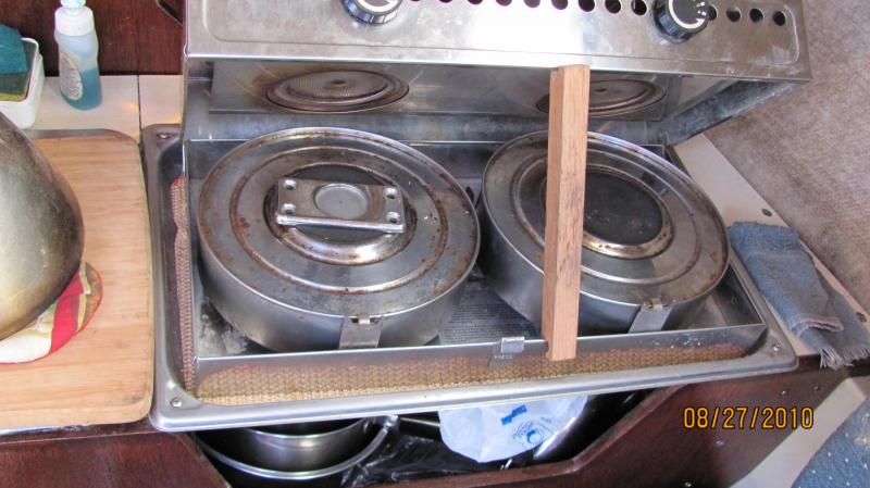

I don't like pressurized alcohol stoves. The canister type stoves are safer to use. As I mentioned though, alcohol is very pricey and you need to make sure that the canister is cooled down before you cover the canister with the rubber gasket.
I found a neat way of conserving the fuel in the canister by cooling it off immediately with a damp wet rag. I keep the stove open with a stick and as soon as the top of the canister is cool to the touch, I just place the gasket on it and use a metal plate to weight it down.
When the stove lid finally gets cool, I remove the steel weight from the canister along the stick, and then I close the stove.

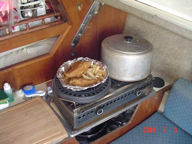

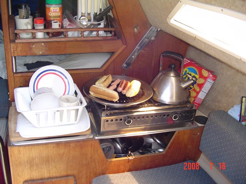

I've been using my single burner Origo which allows me to move my table over the sink. I hadn't been able to do that with the two burner stove since I change my galley cabinet over. I usually slide the stove over to the left when I want to use my stove-top oven or my stove-top grill. The stove sits on a stainless steel restaurant type steam steam table pan which is screwed to the top of the cabinet, with a non skid rubber mat under the stove to keep it from sliding. With fuel prices as high as they have been, I find that I can get away with a single burner stove for all my meals on board.

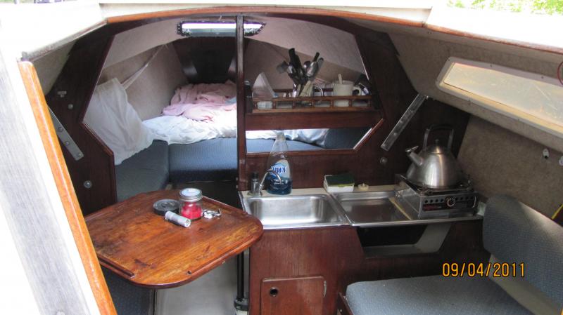

What I would do is find a stove that is very safe and easy to use. I like the non pressurized alcohol stoves myself like the Origo. Cook Mate is another good stove and is a little cheaper in price than the Origo.
In that first picture of Sunbird's reply, the stove in that boat is a Homestrand pressurized alcohol boat stove. I had one of these stoves many years ago and I found it to be a fire hazard on a boat. There is no bottom plate to that stove. If you have two burners lit and one suddenly goes out, the priming tray keeps filling with alcohol until it overflows and gets ignited by the other lit burner. I don't like this stove and I would never trust it. You won't get this with a canister type non pressurized stove. You do need to make sure that loose paper or anything flammable in the cabin doesn't get blow around and come in contact with any stove or hot utensil on the stove. All you need is a damp wet rag to put a flame out on these stoves.
