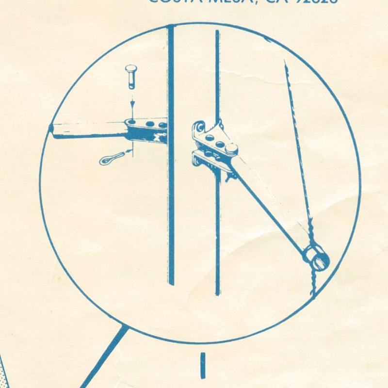

You described your spreader setup to be the "newer" version, not using the through the mast bolt, my assumption then was that your boat is a 1976-78 model with the taller, fractional rig. On those masts the spreaders were mounted using the above pictured brackets which allow the spreader to swing forward but not aft. Generally, the spreader will only swing when there is little to no tension on the shroud, like when the mast is unstepped. Tension on the shroud will generally "lock" the spreader from swinging. I have added a drawing of how the spreader mounts to these brackets. (the drawing is from my DS II manual, so does not show the lower shrouds as used on the 20)
These were used on the fractional rig, the earlier (1973-75) masthead rig used the other spreader bracker setup that had the bolt through the mast.

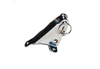

I did notice one thing..... on the D&R web site, Rudy lists 2 different brackets for the 7/8" spreaders used on the masthead rig, look just above the one that is a through bolt..... that one may be a socket with a tang welded on for the lower shroud. No picture, but I think it may be the bracket that I have pictured below? That one would still use a bolt through the mast, as far as I know.

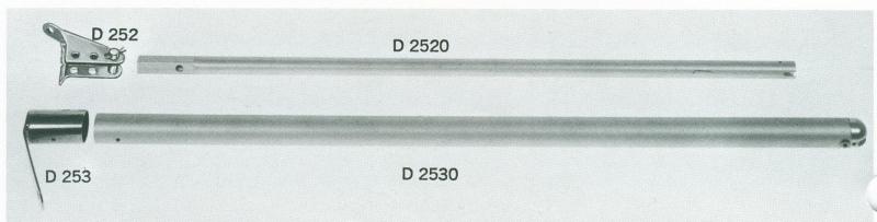

The attached pic shows the 2 types of spreaders used on the 20. Top one is for the fractional rig, bottom for the masthead rig. These are from the DWYER Mast catalog, DWYER was one of the companies that supplied spars to O'DAY, however many companies use the same parts. (Kenyon and Zephyr also made O'Day spars.) (Newer O'DAYs [mid-late 1980s] may have had Isomat or Z-Spar masts, those were very different from older styles)

Thank you Sunbird. This is exactly the information I needed. My spreaders are definitely the lower set you pictured above. I'll follow up with D&R as a start.
