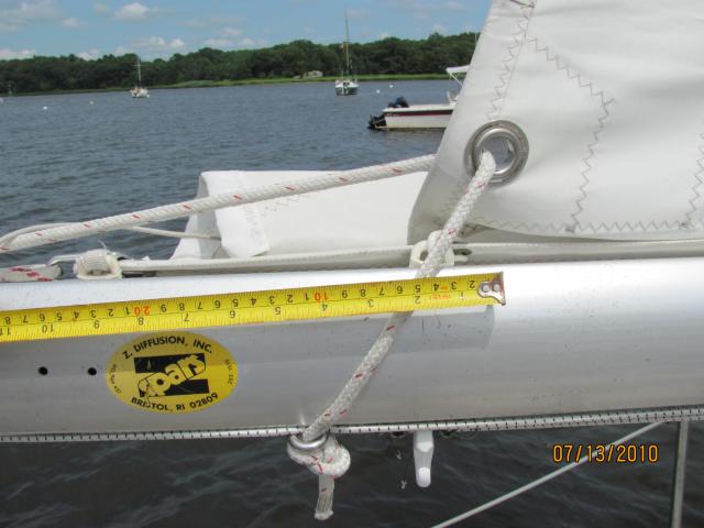

Hi Nelson,

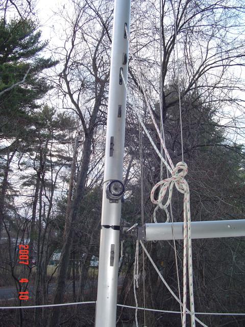

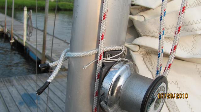

I not only have the answers but I also have the pictures. If you would like to come down and see us, I could make arrangements to meet you at the club once we get into full operation next month. I plan on having the water turned on in the club house this Monday and the docks will be going in at the end of this month, I hope.
Your jiffy reefing should be similar to mine if you have Z Spar mast and boom with internal halyards.
My boom has three control lines. The reefing line is on the Port side of the boom. The clew out haul line is in the center, and the topping lift control line is on the Starboard side of the boom.

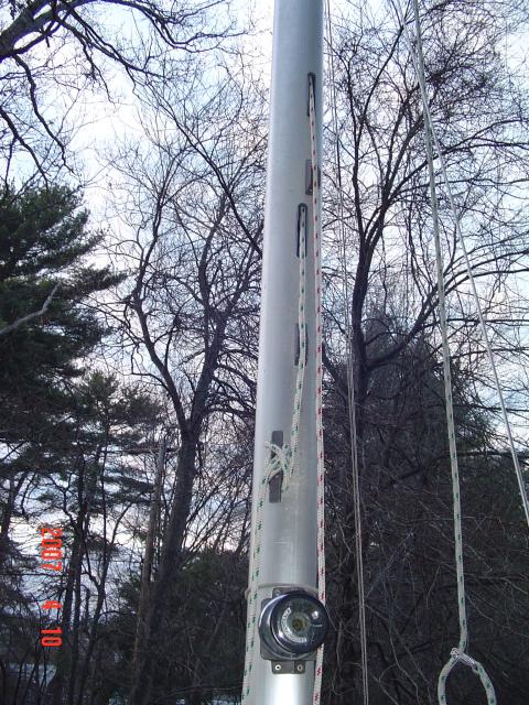

Before you reef your sail, you must remove the last sail slide from the track. If the sail is already up, I set the topping lift to hold the boom.
Then I lower the sail enough to drop the sail slide out of the track.

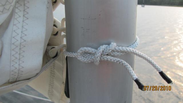

I have a short thin braid line that I use as a sail stop. The line sits over the winch and under the sail slides.
In this case, after I've removed the last slide from the track, I tie the short line under the next sail slide using a reef knot.

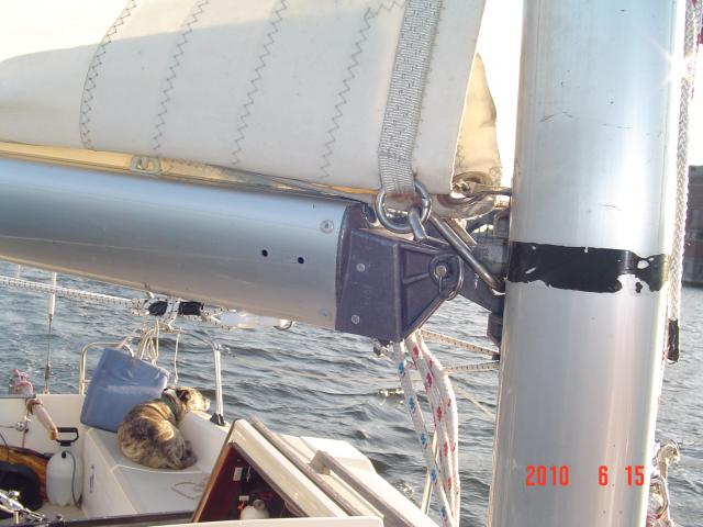

Then I lower the main halyard and insert reefing grommet on the luff of the sail, over the reefing horn or "ram's head. The run the sail all the way up and cleat it off at the mast.
Then I pull on the reefing line and snub it off at the goose neck.

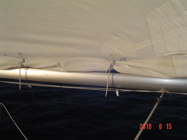

The topping lift is let off and the loose foot of the sail can be rolled and tied off with the reefing points.
I have sail slides on the foot of my main sail and I tie the reefing points around the rolled sail between the top of the boom and the bottom of the sail in between the sail slides. You sail may have a bolt rope that slides into the groove on the top of your boom.
If your sail doesn't have sail slides on the foot, you would need to tie off the excess sail by tying under your boom.
It's pretty simple once you get used to it.

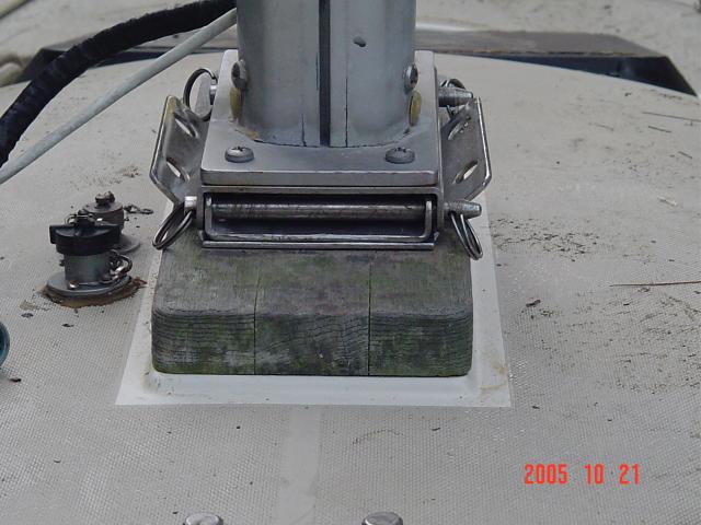

I don't believe I have the same mast as you, I can tell by the tabernacle. When I stopped by D & R last Sept they told me they can't get replacements for my tabernacle any more unless I had it fabricated. I wasn't too happy to hear that.

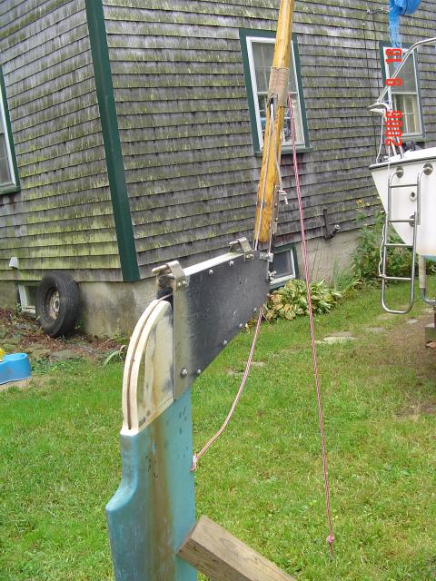

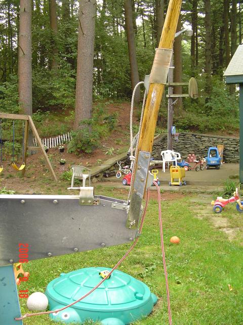

I had that stainless steel hinged tabernacle installed back in the mid 1990s. My old tabernacle was similar to yours if you have Z-Spar. I had a guy a Rig-Rite install an exit plate on my mast for my Jib halyard, in the same area as the exit plate for the Main halyard. This eliminated the sheave at the bottom of the mast step, which is a set up that I hated.
You would be better off having Rudy order you a hinged mast step similar to mine and have it installed on your mast. I have a Kenion tabernacle with a utility plate on my boat. Dwyer Mfg makes a plate exactly like it. I would buy the utility plate with it.
You could install the lower half of the Tabernacle and utility plate on your cabin yourself. If your stays are still in good condition and you still want to use them, you will gain approximately 1" or a little more of slack because of the difference in height between the two tabernacles. The original tabernacle having a sheave at the bottom, will be higher than the new tabernacle. So you will need to make up the difference in order to get your stays to come out right. You could always shorten your stays, but it would be more costly to replace the swaged fittings.
I raised the Tabernacle on my cabin by mounting it on a 1- 1/8" thick Teak block. I recommend this highly because it can be very beneficial down the road some day if you ever decide to buy a good roller furler and build a Gin Pole to raise your mast. The 1" will allow your mast to lay almost horizontal when it's pinned to the tabernacle and ready to be raised.
In the pics, the white halyard with the red flecks is the Jib halyard.

That was a mouthful to swallow all in one bite but will take it into consideration once other expenses are out of the way. I'm curious what the cost was for having the hinged tabernacle put on? I think my boat is pretty stock and I believe it has a few small things that broke along the way and were never repaired. It used to belong to another person that was on this board and the boat was named Shady Lady.

Off hand I couldn't tell you what the cost was back then because the insurance company paid for everything including a new mast that I lost out off Newport. The whole bill came to $2400 include three new stays. You may be able to do this job yourself if you're handy. At the time though, I wouldn't have known how to do it. All I knew was that I wanted a stainless steel hinge plate instead of that chintzy cast Aluminum plate that was on there. I got together with the rigger and he told what he could do to reroute the Jib halyard and he went ahead and did the work. Now that it's in place, it looks so simple to do.
It's a good idea to insulate the stainless steel hardware from the Aluminum in the mast or corrosion can set in. Some guys use plastic from a milk jug. I coated the Aluminum with epoxy and let it dry before inserting the mast plug that holds the Tabernacle. I did this about three years ago when I was working on my mast wiring. I had to have my mast welded and the welders get $80 an hour. So if you plan on having the extrusion on your mast welded, you need to decide whether you want to put $80 into an old mast step or replace it for a little more money.
I love the set up that I have now and when I had a conventional Gennie set up, I was able to use the mast winch for the main and the Jib halyards. The CDI Roller furler has it's own halyard and the Jib halyard is not used. I only use the Jib halyard now for raising/lowering my mast and that's it.
