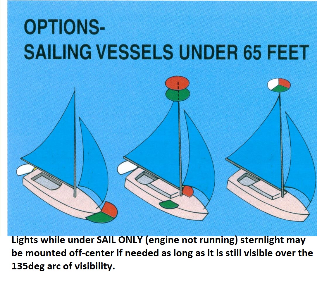

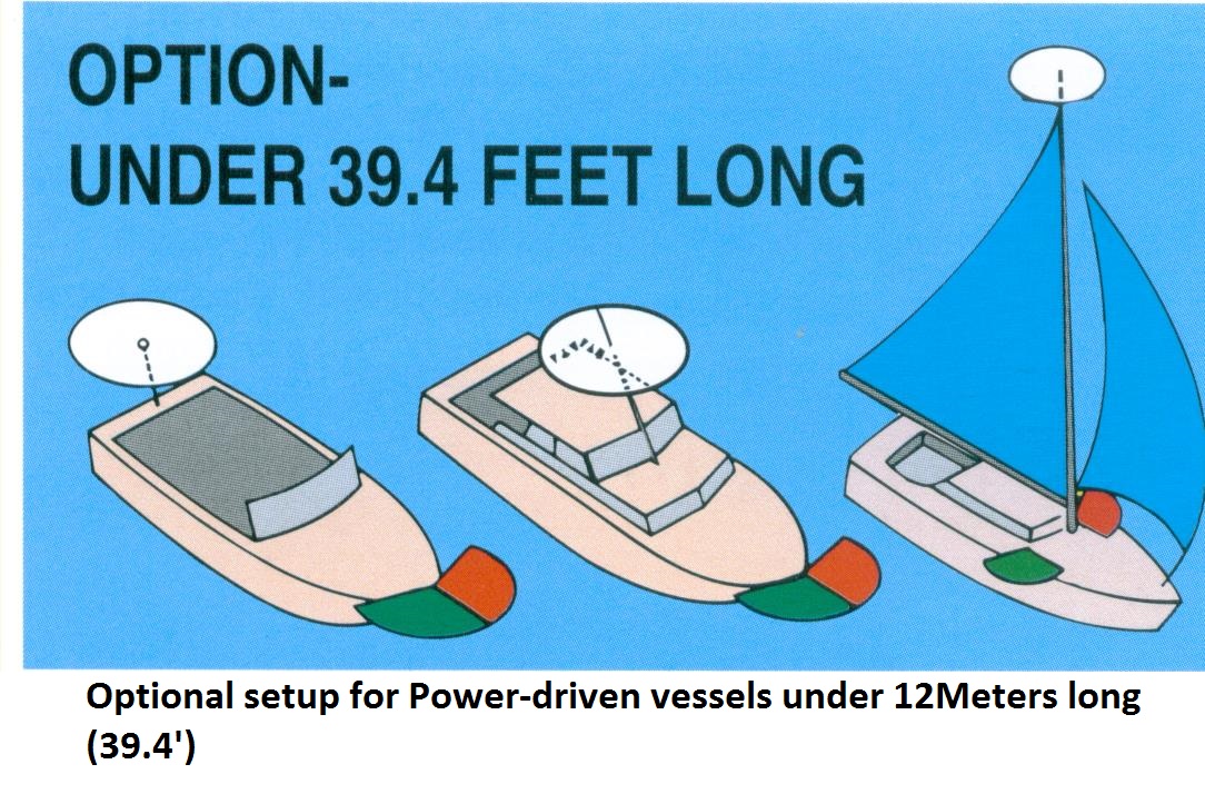

That LED Navlight is intriguing, except for the fact that a magnetic mount won't stick to a proper marine railing which should be (if metal) stainless-steel or bronze, neither of which will be attractive to a magnet. Second, these lights are great as long as you make sure they will point in the correct orientation (red to port, green to starboard, white aft, with proper arcs of visibility),also a tri-color light can NOT be used while under power, only under sail or on a manually propelled (oars or paddle) boat. If that LED tri-color were used it would really need to be located at the top of the mast to be visible 360deg.
As soon as you start your engine (if you have one), you are a powerboat and must display the correct lights for a powerboat.
If under sail (engine not running), a vessel under 23' can use a white flashlight to shine on the sails if another vessel approaches (I have the installed lights, but still carry that flashlight and shine it on the sails if needed), but I would want to be REAL careful to always watch for other vessels and turn on that flashlight as soon as possible if there were another boat nearby. If using portable NavLights, be sure to carry spare batteries and bulbs. I used to burn out at least one bulb every year in the portable lights that I used on my Widgeon.

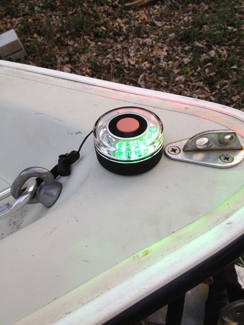

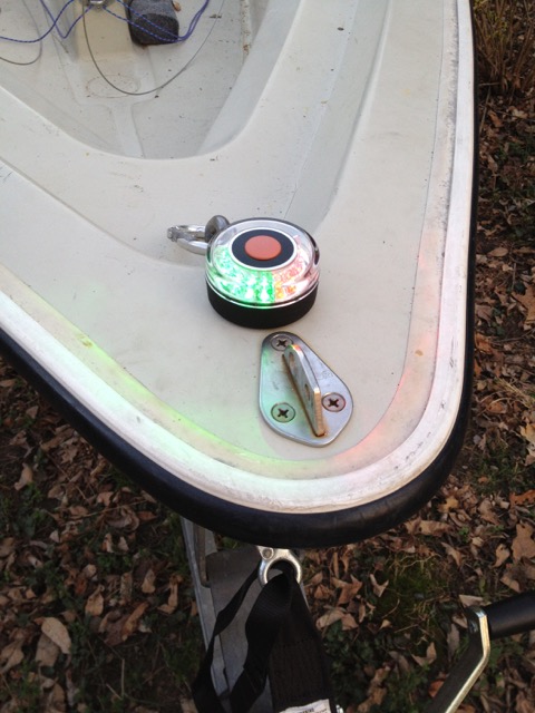

Sunbird, I used a NaviSafe tricolor light on my Whaler Harpoon 4.6. I mounted the magnetic mounting plate just behind the stemhead fitting using outdoor double sided foamy tape. The magnets align the light properly to this plate. I used a clamp on LED "flashlight on a stick" style for stern light, because I had one given to me. Not nearly as bright as a NaviSafe 360º would have been, but "free and works" trumped "expensive but better" in this case. I don't hesitate to recommend NaviSafe stuff, it was high quality and well thought out.

That Tri-color on the bow is not a proper NavLight in that location, you are displaying 2 sternlights using that (yes, one is now at the bow, but there are 2 aft-facing white lights, your flashlight and this tricolor). You need to cover over the white part of the tricolor if mounting it on the bow like that. Also, make REAL certain that that light is properly positioned s that the centerline of the light matches the centerline of the boat (so division between red and green is not angled off-center), light does not absolutely need to be exactly on-center (can be offset to port or starboard slightly), but lights must show proper arcs of visibility in relation to vessel centerline.
Remember, improper navlights will shift more of the blame to you if a collision occurs, no mater how unsafe the other skipper's actions. Improper Nav Lights is also one of the prime reasons that USCG and other Enforcement Officers will board vessel for (lack of or improper display of registration numbers is another). The NavLight setup that you describe will not meet legal requirements and will not pass a USCG boarding or even a VSC (Vessel Safety Check) offered by the US Power Squadron or the US Coast Guard Auxiliary.

Sorry, Sunbird, and others interested in the Navisafe products. The tricolor light has many lighting modes: all 3 colors, red only, green only, white only, or red and green only. Because my pics were taken during the day, it's hard to see that I have it set to red/green only mode. Of course I oriented the division between red/green right on the centerline. I did not use the white lights on this light, because I had an all around white on a pole mounted to the transom. While that is correct for a small powerboat, but incorrect for a sailboat, I felt that it was very safe where I was most likely to be sailing at 15' boat.

The Navisafe is then a lot more useful that it sounded, ad worth promoting! Yes, technically a sailboat underway at night should be showing a white light, 135deg total arc, 117.5deg each side of centerline. The 360deg white light is a powerboat, however....... at least you have a sternlight, unlike too many powerboats! My "favorite" are the powerboats that are not showing the forward white light (masthead or steaming) but only the lights that would be proper for a sailboat under sail.... amazing how fast some of these "sailboats" go! Also far too many powerboats (and a few sailboats under power) do not show the 360deg. white light high enough, it must be at least 39" (1 Meter) higher than the sidelights. I like the old Boston Whalers that had the light 6' above the cockpit sole, since that usually put it above the heads of anyone on the boat, and the higher the light, the less glare shines on the boat.
So, anyway, I stand corrected on your tri-color, a long as the aft-facing white part is turned off, that is a great little light!
