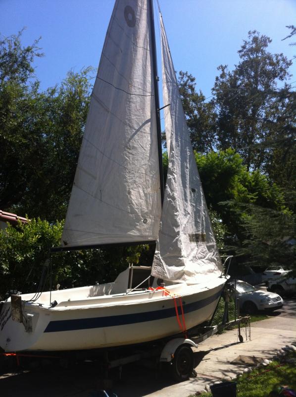

As some of you have been following I've stumbled in to an all-but-free O'Day 19 that I'm making shipshape. I'm hoping to launch this weekend, but can't get out of my mind that the boat is not self righting and has such little ballast (300lbs).
This for me has been a struggle as I've sailed 25'+ and 14'- boats. The big boats obviously never had any issues like this, my old Cal 25 for example. The small boats were small enough that going over was part of the fun.
Any thoughts on the seaworthiness of this boat? Any advice? I like to play hard, but I'm a bit nervous with this one. If I dump it with my family it's not going to be a laugh and a few minutes standing on the center board...
Thanks!
-Aaron
