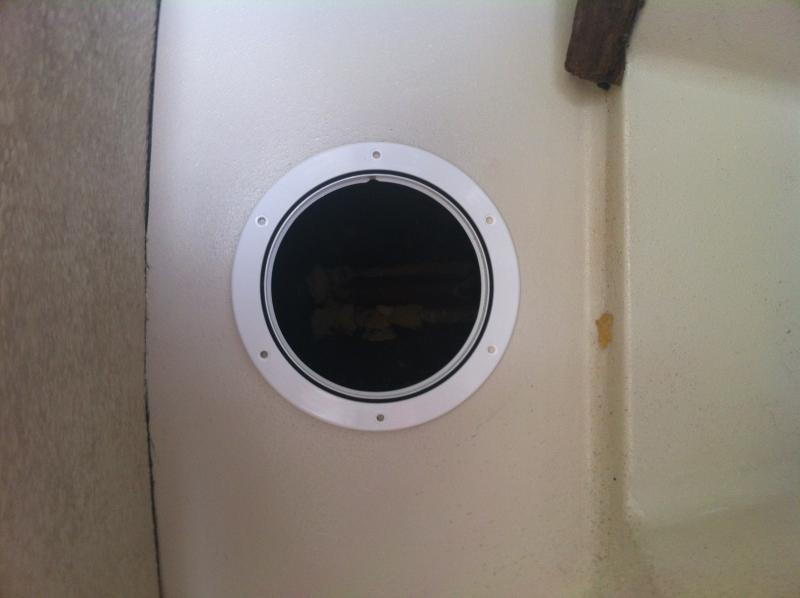

I'm planning on going the same route myself. Just picked up a dual post bow eye, 6" inspection port, etc...

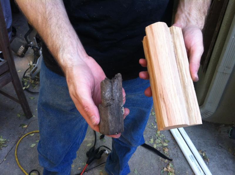

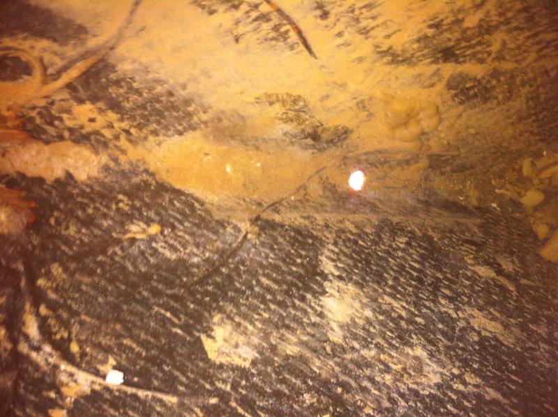

So here is a pictorial of what I ended up doing. You'll see the new inspection port after removing two kitchen sized garbage bags worth of "chunked" foam. Followed by the hole in the bow. Finally a picture of the new oak backing against what was left of the old wooden backing.
I did go with the U shaped, stainless, 2500lb rating bow eye. That obviously required a new hole. Everything was filled and/or slathered with Life Caulk.
