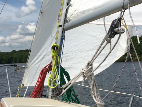

Blue line along mast is downhaul, grey line is vang. (Yellow is spinnaker halyard, red is jib halyard, and green is main halyard. Some have complained about my multicolored approach to line choice. :cool:)
