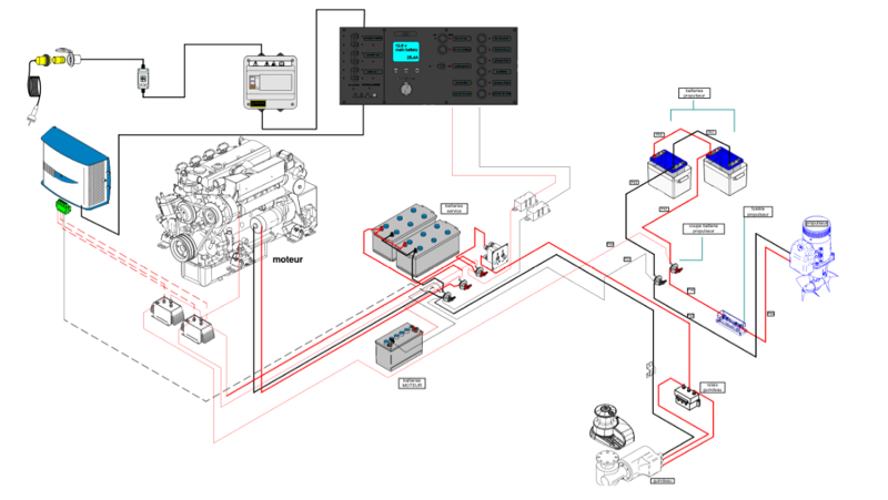

We've recently taken delivery of a new Oceanis 37, and we're just starting to make it our own and understand all of the systems. In the process of looking things over, we noticed that the battery for the bow thruster, in the front cabin, does not charge off the battery charger. It does charge off the alternator. When we look at the electrical diagram in the manual it looks like there should be leads from the charger to each of the batteries:

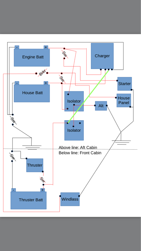

In the manual for the charger (Xantrex TrueCharge 2), it looks like there should be the capability for three battery outputs. When I traced out the existing connections, it looks like there are only two leads from the charger to the house and engine banks, but none for the thruster. Here's a rudimentary sketch of the connections I could trace. The green line is what I think is missing.
We asked the dealer, and their explanation was that there was no wiring to support a charger connection to the thruster battery. They also stated that a more recent 37 they got in is wired the same as ours. They did say they put a call in to Beneteau to find out what the correct layout is, but they haven't heard back yet.
Anyone else with a 34 or 37 know if their charger is connected to the front battery, or any reason the green line I show shouldn't be added?
