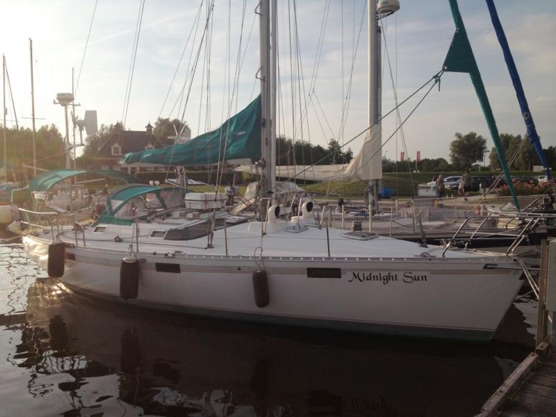

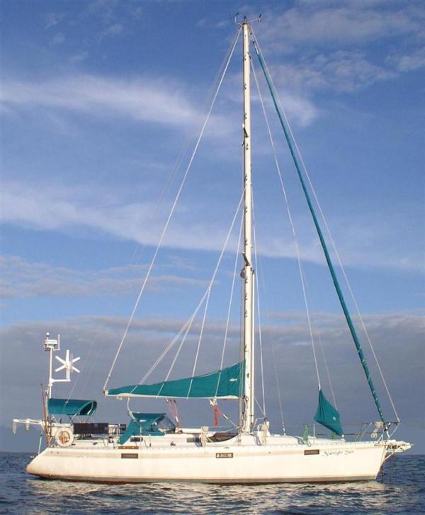

We have a additional second baby stay on our 390 with a small jib for upwind-sailing if we have more than 20-25 knots of windspeed - it works well - you can see the jib with the green cover on the attached picture. On the other picture you can see the position of the mounting of the second baby stay right behind the anchor-box. In the front cabin there is an additional metall-construction to absorb the forces from the stay.

I do not recommend carrying a sail on the baby stay. On so_farr's boat his additional stay runs to the top of the mast where it has a counter force from the backstay. the other baby stay has no aft support and is designed to hold the mast forward in place of forward lowers. If you rig a sail to this stay you would have to add running backstays to counter the forward pull in the middle of the mast. this is why boats with a staysail use running backs. I do not think the aft position of your mid stays would be enough for the loads of a sail.
There is a 390 in the marina I am in and I did a survey on it a couple of weeks ago i will go take a closer look at the setup this week to see for sure
