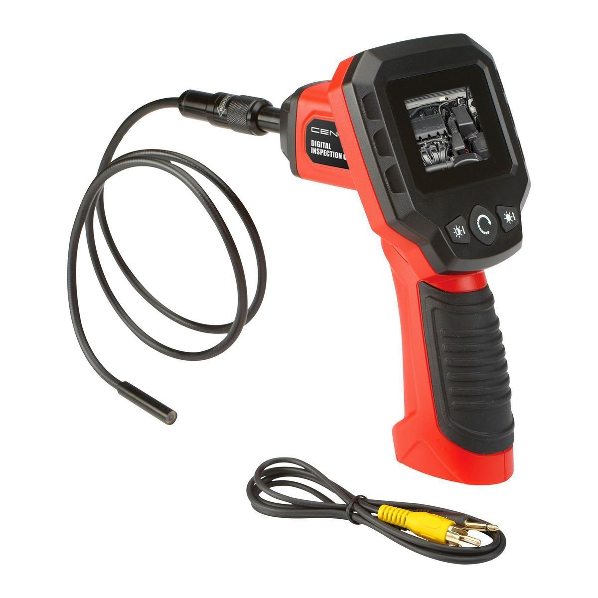

Perhaps one of those small inspection cameras could help you look inside and show what is happening to stop the wires from going through.
Something like this.

Thanks very much for your reply. Funny thing - I just came to the same conclusion as I have one of these inspection cameras I haven’t used for a long time. I will give it a go - I think it may shed some light on the problem.

After much patience & several attempts, I succeeded: the inspection camera was difficult to direct in the void above the engine and the clarity was not great but it did confirm sufficient gap between the cabin panel and GRP shell. In the end I enlarged the hole in the wood panel next the the ceiling light wiring and fed a loop of seizing wire down through the hole at ceiling level; with the aid of the inspection camera, I luckily managed to hook the wire loop with a hook made from a coat hanger. I was then able to connect the two solar panel wires to the seising wire and cautiously pull them through. I was able to slide over some flexible conduit so that at least the wires passing down the side of the engine compartment are neatly enclosed.
