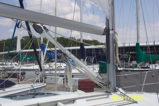

I actually have a couple of other views but would have to keep sending them as new posts to get them 2 you. I'd offer to e-mail them but I'll be away from my computer for the next month. In this photo, follow the red/white out-haul line that goes through a rope clutch (not in picture) then deck organizer (hidden by the date), then a block at the base of the mast, then up into the boom, around a shieve inside the aft end of the boom, then through the out-haul car on top of the boom, then around a shieve on the sail and finally back to the outhaul car. Mine is secured to the car with a bowline. Next follow the green/white furling line. It goes through the rope clutch, then the deck organizer, then a block at the base of the mast, then up to a block on the underside of the boom to the furling drum. Hope this helps
