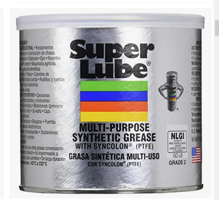

Once you have the new O rings, keep them in pristine condition by coating them with a NON-petroleum grease (synthetic grease) such as Superlube. Every couple of years is often enough. Mine are 24 years old and could pass for brand new.
Ralph, is it okay to use Superlube on the water deckfill O ring or would it do a salty ol’ guy in?
+1 for SuperLube grease..It's what I've recommended for years to lube manual toilet pumps, winches, y-valves, seacocks, etc. You don't have to buy a whole can of it. Ace Hardware also sells it in a tube, which makes it a lot easier to use and also easier to store aboard.
SuperLube has a complete line of lubricants...be sure to get the thick grease.

just bought some yesterday at west marine ... pricey ... so if you can find hem at Ace go for it
