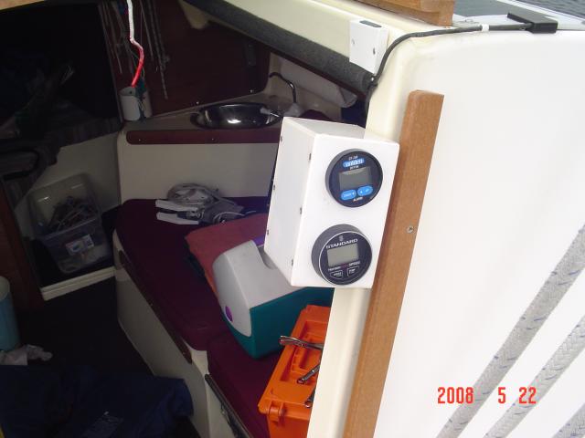

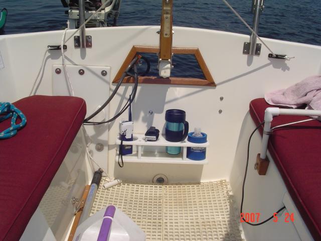

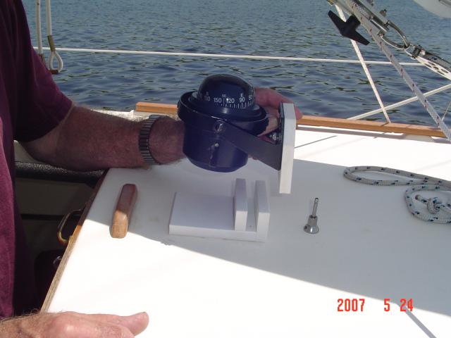

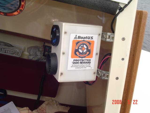

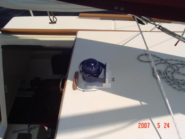

I have my compass mounted on the Starboard bulkhead with a wire for the compass light. I wasn't too keen on boring a 4" hole through my bulkhead either but I've had that same compass for as long as I've had my boat and it is still in great working condition.
Here's some ideas you my want to persue that involves DIY with StarBoard compliments of my friend Wayne who let me take these pics.
