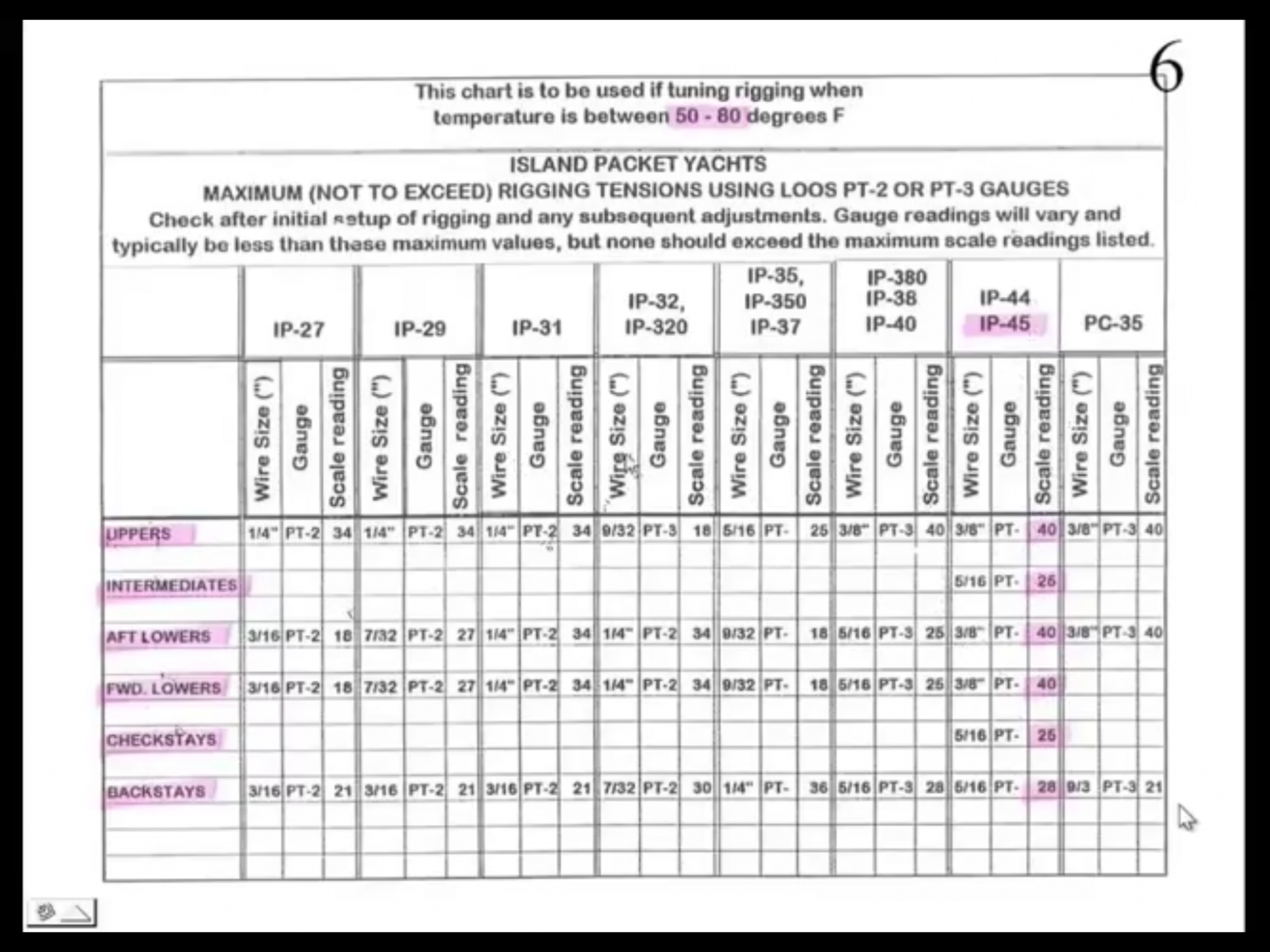

I am new to the sailing world and would like to know if anyone has a rigging tension guid Or a resource where I can get one

have not heard of a guide "per se". Identify your wires by size and number of strands and look up the breaking strength for it. Tighten them to 20 to 25% percent of the breaking strength using a Loos Gauge. Determine whether your boat has a "mast rig" or "fractional Rig", Keep the mast straight by gradually, and alternating tightening and the shrouds on both sides. On a fractional rig you must determine the amount of bend for the mast. Check the Forum Archives as there should be some postings on how to tune the rig.

If you want to get into more nitty-gritty of your rig, and a variety of other rigs, you could check out Seldén Mast's rigging guide, available as "Hints and Advice" PDFs to download here: Rigging instructions & sailmakers guide : Seldén Mast AB
One thing you should be aware of is that the 222 is not designed as a performance boat, and rig tensions recommended by Seldén are, in my opinion, way too high for the boat. In fact, the original O'day rigging guide describes the rig as "hand tight" if memory serves.

A lot of good info here. On my 222, I go by the owners manual and make the upper shrouds hand tight and the lowers taught. It works out to be about 120 lbs on the Loos Gauge. The literature of the gauge suggests about 220 lbs for the size wire of the 222 rigging. It's OK if the leeward shrouds go a little slack. That's the shrouds stretching and the hull deforming under the pressure. My sense is, that 220 lbs of tension constantly on the rigging is going to distort the hull somehow. This is a small boat with thin hull material, although stronger than many boats of similar size. I can tell the shape changes because the safety lines are sometimes taught or slack depending if it's on the trailer or in the water for a period of time. I do most of my sailing on the Chesapeake in the early and late season. The winds are mostly in the upper teens and gusting into the 20's. The Vang is on hard to maintain sail shape and that's where a lot of pressure on the rig is coming from. The thing is, when you're not sailing, the Vang is off. If you purchase a Loos Gauge (Amazon), all the instructions are in there. If you're a new sailor, just go sailing to get the feel; and watch the tell-tails on the leech of the main and keep them streaming.

For 1/8” diameter wires (as found on side shrouds often vast majority of 22 foot boats), 10% of breaking strength is around 180-190 foot pounds.
