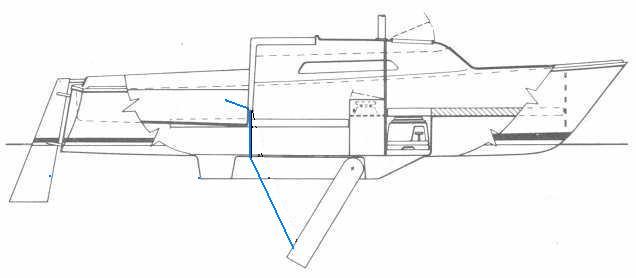

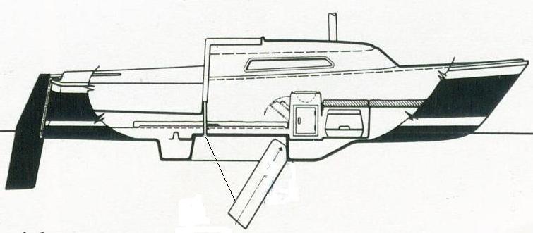

Centerboard issues at all with ODay20?
Hope everything is going well with your 20. Was just wondering if your centerboard is fully operational? Ours is stuck in the up position, the centerboard line housing/pipe seems to have some issues too. This looks like an ongoing problem that our vessel has had. If your centerboard is fully operational - and you happen to have any photos of the centerboard line housing, that would be most helpful - we can not tell what is missing or wrong - no drawings found or close ups. Snorkeling might be in our future. Thanks and hope you are enjoying your ODay 20 by now.
Jun 2, 2004
1,948
Oday Day Sailer Wareham, MA

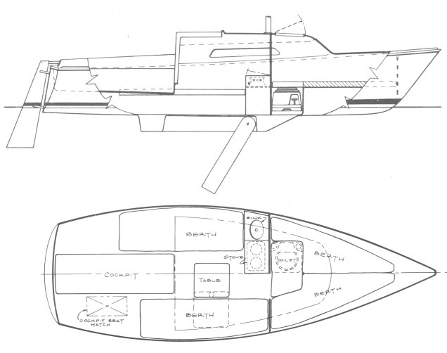

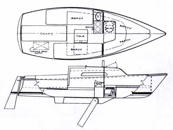

Sailinsally, do you know what year your 20 is? 1973-75 or 1976-78 ranges might be close enough. One clue is the type of rig, 1973-75 is masthead rig (mast was shorter and forestay goes to top of mast, 1976-78 was fractional rigged, with a taller mast and forestay attaches to mast about 3/4 of height. The centerboards setup was different for the 2 versions as well, later boats had a shorter, wider CB (when veiwed from the side) the earlier boats had a deeper, narrower CB, I think the basic position of hte CB pendant (line to raise/lower) was the same in the boat, but the dimensions of the CB trunk were different. Cabin layout was different too, 1973-75 had more or less a smaller version of the 22 interior, 1976-78 has a more open interior without a main bulkhead dividing hte cabin. (Cabin structure was re-designed to allow this, so don't anyone think they can just remove the bulkhead from an early 20!
Anyway, drawings below. (dark hull boat is the 1976-78)
