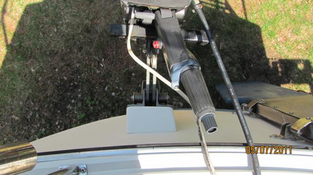

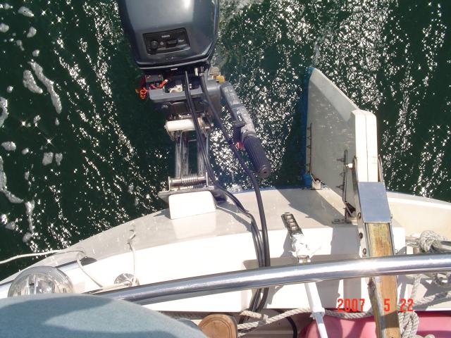

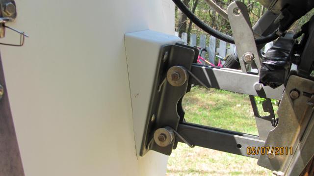

Here's a pic of my outboard motor bracket Stan. My bracket is an el cheapo which is not rated for a four stroke. The block that the bracket is mounted to allows me to tilt the outboard up each time without having to mess with the bracket. The bracket in the picture always stays set in that position. I very rarely ever move it up or down.
Perhaps a block on your transom will allow you to tilt your outboard up and out of the water without having to mess with the bracket each time. I have an 8 hp 2 stroke outboard, but where you have a smaller 4 stroke outboard, the block may give you the space needed to tilt the outboard up.

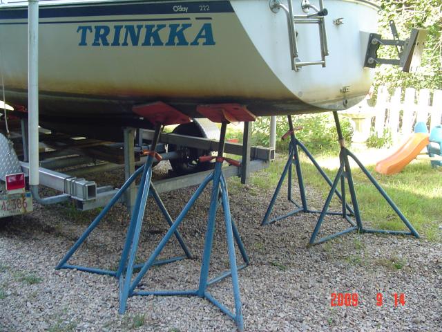

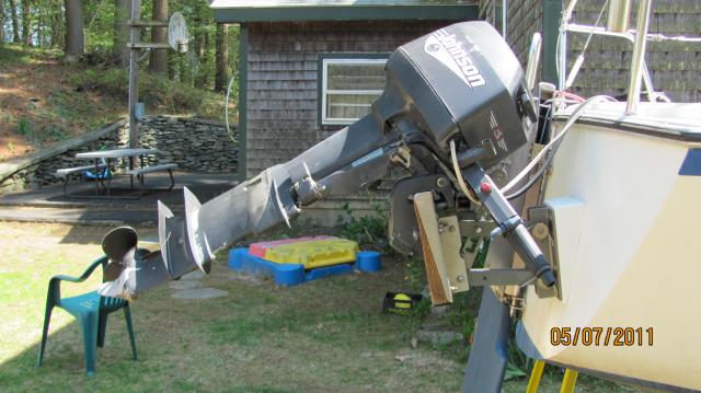

You're right about the blocks being too small for these larger heavy duty brackets. I'm going to keep my two stroke going for as long as I can. Here's some pictures of my block and the el cheapo bracket with my outboard on it.
