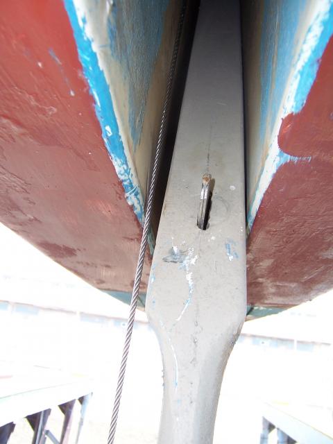

I have a 1979 32 with probably the exact same keel trunk and my experience is to have the smallest thimble securing the cable at the top of the board and a small shackle
Here's a picture try zooming in for a better look

Yes its flush when parked,it pivots on a piece of delrin plastic thats about 2 inch in diameter and I don't have a tang but a reinforced hole through the board at the edge and you mentioned you have a bowline so I'm thinking someone added the tang and between that and your knot there's restriction when it reaches the centerboard cable tube....you do have a tube at the top of the keel trunk?

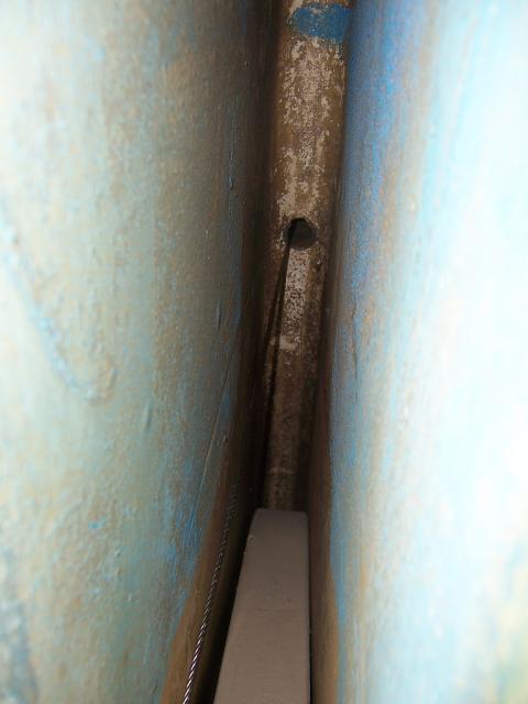

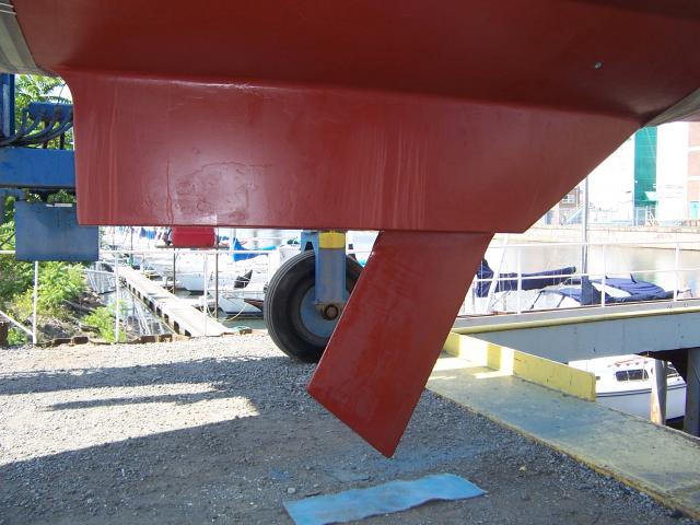

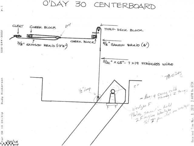

Attached are the CB design spec for my '78 ODay. I replaced my cable/rope line this spring ('10). The cable was fine, the spliced-in rope was rotting on the deck. Pictures are included. I put a small ss shackle from the 2 tangs in CB to the cable loop. Make sure when up the CB aligns with the trunk cable hole. The CB has a 2" Pin that sits on 2 fiberglass wedges. The wedges are held in place by bottom plates screwed into the keel.
I got the CB boat specs from "Rudy" at D&R Marine.

Thanks for the response with the pictures and the drawing!
I removed Paloma's CB yesterday and will work on matching its attachment to the drawing. Notably, our CB did not have the wedges in place any longer, the pennant was all line (which may have created the jamming if the knot became stuck in the lower end of the tube through the hull), and the tang in the board is shorter and probably does not pivot as far as your drawing and pictures show.
