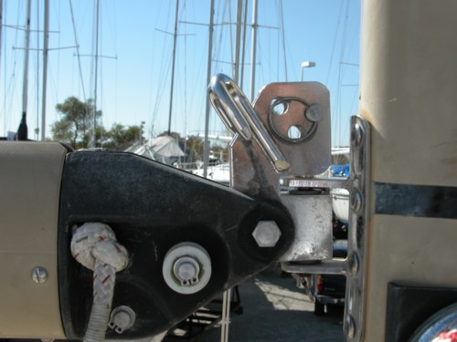

Here is the photo...
Jerry - Here is the photo of the Kenyon arrangement. You can see the pin with the ring in the upper right of the photo. This secures the tack, and it sounds like Mike and I have the same arrangement. One thing I noticed on the rigrite site is that I am missing the cam cleats on either side of the boom that cleat off the reefing lines...perhaps this is the lever you are refering too, and someone ran the outhaul through one of these cleats?? At any rate, looks like I found another project for this winter - namely, replacing the cam cleats for the reefing lines. Jerry, good luck with your quest. Hope the picture helps. Bob s/v Simple Dreams Chicago

Agreed, Mike...
My outhaul secures the same way as yours, on the cleat under the boom. I am not planning to change this, and certainly would not suggest using the aft fittings you described. Do you have cam cleats on either side of the forward section of the boom for the reefing lines to pass through? Based on what the rigrite site shows, these snug up against the small white pulley in the center of the photo, behind a stainless plate, and there is a lever extending forward and down. I was thinking this might be the lever Jerry was refering to, and someone had "rerigged" his boom by running the outhaul through this fitting. Anyway, sad to say we won't have to worry about any of this for the next six months. You out of the water yet? Bob

Ahh now I see, Bob
Bob: I took another look at your excellent photo and noticed what I had missed before. You are right there is a pair of cam cleats with internal springs to secure the reefing lines at the FRONT of the boom; and yours is, in fact missing. It makes the reefing process much easier to finish. Ignore my previous note on those fittings I was describing at the back of the boom it has nothing to do with the cam cleats you need. They are easy to install and maintain since they consist of the two cleats a couple of springs internal to the cleats, a through-pin and some retaining e-clips. I suppose Kenyon may have some spare parts, If not Rudy can probably help out. Yes, I am out of the water and on the hard. Going up to put the custom canvas on her in a week or two. Good thing I like to ski. Regards, Mike S/B Pitterpat, Lake Huron
