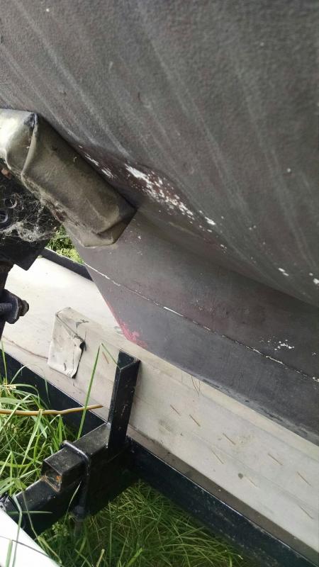

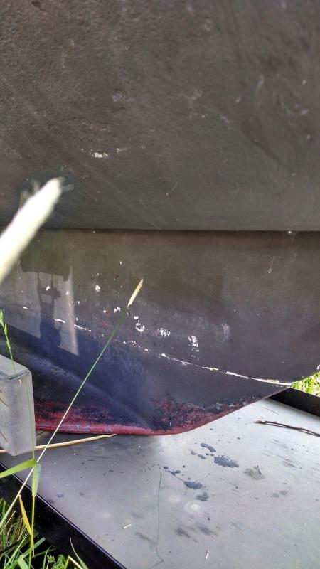

I'm considering moving up to a 240. I have been corisponding with a gentleman that has one for sale. I haven't looked at it yet. I have received several photos. Looks clean but my one concern is the keel. It may be the lighting in the picture but it looks the keel stub isn't fiberglassed to the hull. What do you think?

The keel bilge area looks normal but it is impossible to tell without better lighting of the bottom of the keel showing the bolts and backing plates. Our 272 has one of the bolts under the corner of the head floor (forward of the main cabin) but O'Day did provide a removable access floor hatch above that keel bolt for visual checks.

I think its a bit of an optical illusion caused by lighting. I'm guessing the dark line is a shadow. The keel stub is an integral part of the hull; its one laminate. The lead keel is only the lower half (you can see the form line).

Thanks, I think your correct. I will certainly get a better look once I check it out.

To answer your question, though, the keel looks ok to me, but try to get a better look at the bolts from the top, and the bilge area overall, to see if there is any evidence of leakage at the keel/hull joint.
