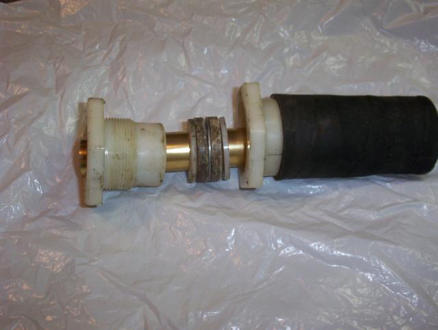

Repacking a Hunter 28.5 OEM white nylon stuffing box can be a challenge due to a number of factors. The first is that there is very little distance between the box and the coupler so getting the old packing -- AND compression washers -- out can be really difficult without removing the shaft. I tried all sorts fo picks to get the washers and old packing material out, and it was really hard. Take a look at the pic below to get an idea of how the 2 packing rings and 3 washers inside the gland are set up. I found it very difficult to repack such a gland, but more importantly, I never trusted it. I replaced mine with a conventional bronze packing gland when I replaced the cutless bearing and it is really simple to service.

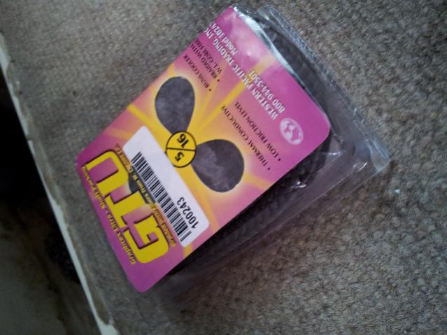

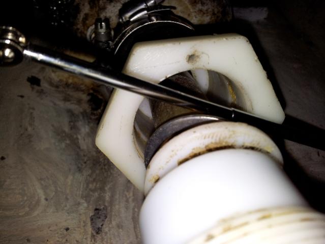

I just re-packed the nylon-style stuffing box on my 28.5 today. It wasn't very difficult, other than being a somewhat cramped location. You have to separate the box from the hose so that you can twist/pull the box aft to free the forward nylon washer. From there it's a standard pick job.

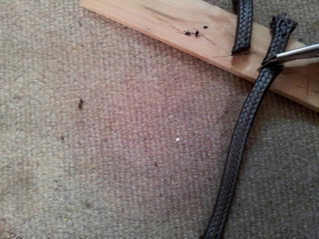

I re-packed with 5/16 GTU, and started the angled flax cut on the shaft to mark the length, then finished up on a cutting board to make it easy.
It takes two packing rings of course, one on either side of the metal washer (nylon washer, flax, metal washer, flax, nylon washer).
Freeing the box from the hose also allows for a complete inspection. My box was in great shape with no cracks or wear in the nylon.
