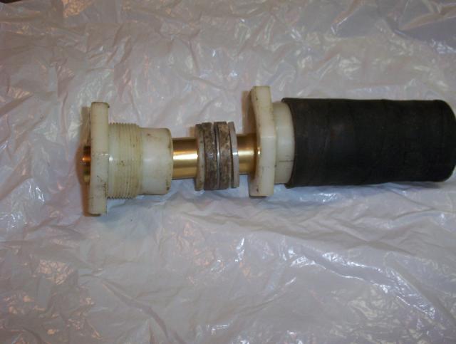

Here is what my OEM white nylon stuffing box looked like on my '86 H28.5 before I replaced it with a conventional bronze gland. If you gland is packed with the right size packing material, and the compression washers are in place, the my guess is that your shaft may be scored which would prevent the gland from making a correct seal.
