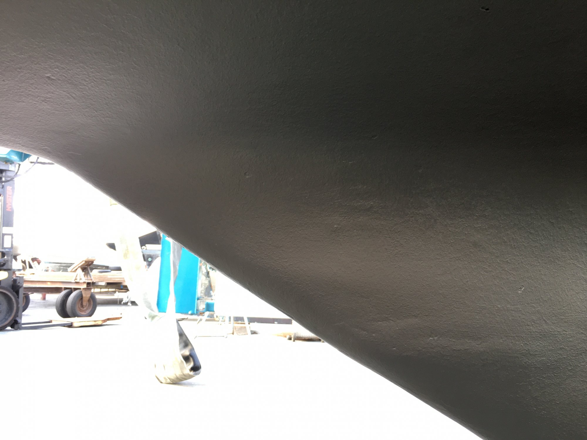

Here she is with the paint done. I fixed her small Catalina smile, it came out fairly good but could have been faired a little better. The rudder void got filled, new cutlass bearing, new zincs and at the last minute they helped me get some mega rusty bolts off of the old exhaust mixing elbow and replaced it with a new elbow, bolts and gasket.
There is likely more I could do and should have done while she was hauled out but the money well is/was running low and I had to call it quits at some point. I just bought not all but most running rigging to replace. Next up is a standing rigging survey then I'll replace what is needed. For now I'm back to filling the money well... Last photo is of me on my first time out taking her from Dana Point, CA to Shoreline Marina in Long Beach, CA. It was a 32 mile motor up wind against the current. I didn't attempt to sail because I need more experience. No, that's not a beer or a cocktail, it's a soda!
