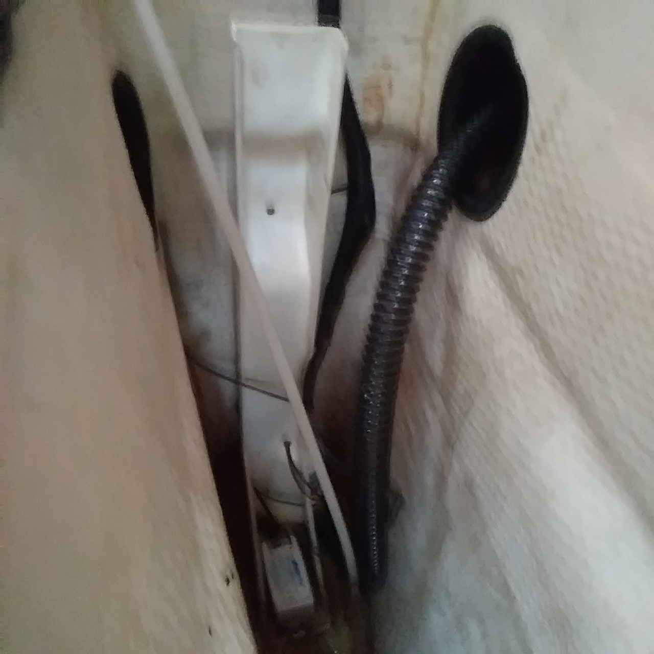

I’ve recently purchased A 1999 H410. I live aboard with my golden retriever and want to be able to regularly inspect/maintain the bilge pump. I’ve been puzzling over how to reach both the pump itself and the associated float switch.
what is this piece that “REACHES DOWN”
All I’ve been thinking is that the fool who designed this weren’t thinking about servicing

The part that reaches down is a fiberglass piece that fits up against the aft wall of the forward section of the bilge (there are 3 sections in my bilge) and is secured with one screw. The bilge pump attaches to this and can be lifted out. Other items like a high level alarm etc could be attached. I'll be going to the boat tomorrow to get reading for the upcoming storm so if I remember I'll try and take a picuture. It is a very deep bilge and this really is a convenience.

Here is a picture of the piece that reaches down. The bilge pump is attached to this as well as the float switch. You just undo the small screw that holds it in place (seen in the pic) and lift the whole thing up, pump, float switch and wires and all. You could easily make something similar with starboard or some other similiar material. Hope thi helps.
