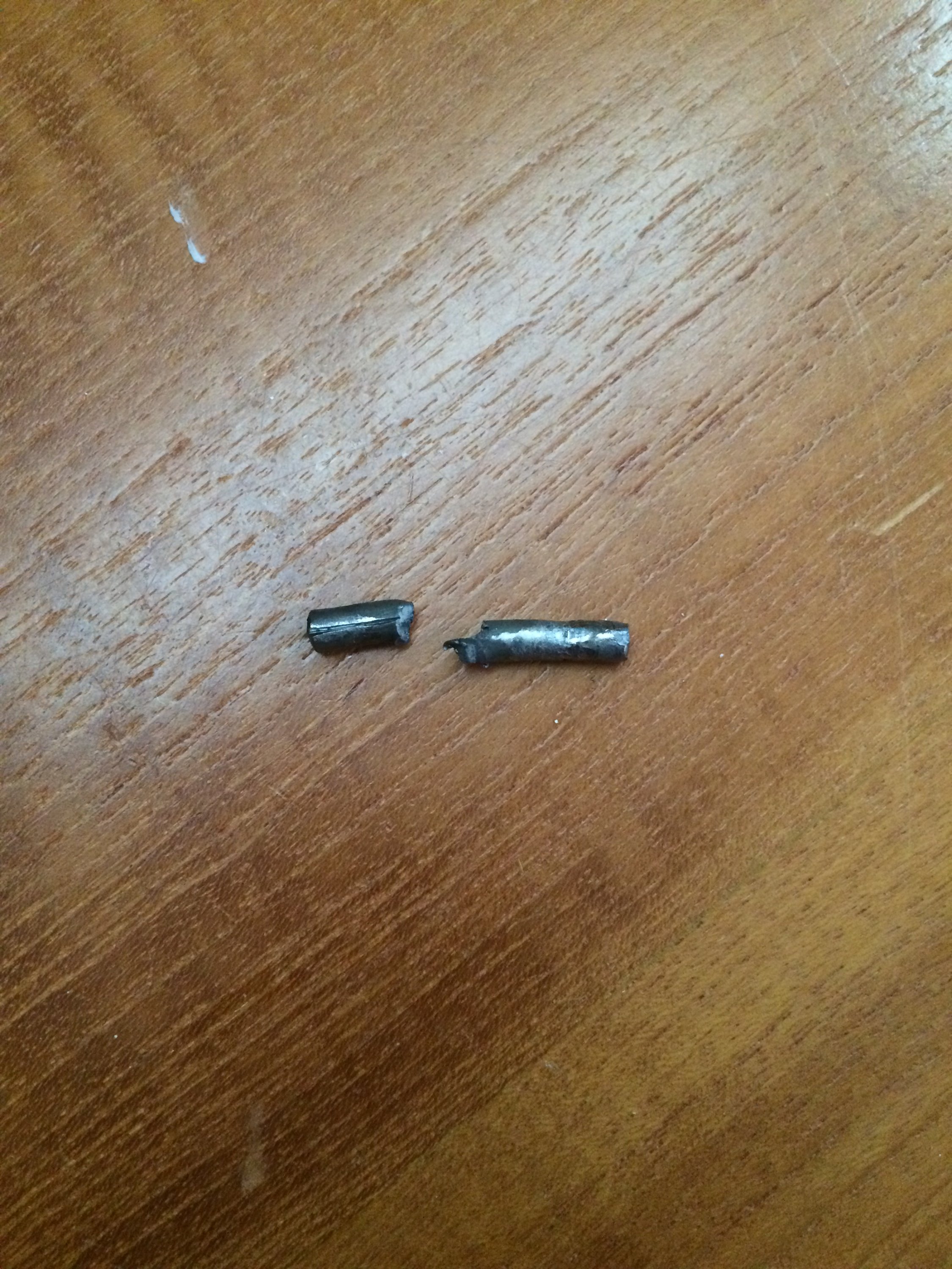

Yep mine is a Side Power SE60. I just bought the boat from someone that used it very lightly and he said the motor pin broke once or twice on him and it just broke on me after using it only maybe 10 times very short bursts. I went ahead and ordered a few pins for when I go to change it because he may have used the ones taped to the motor. It doesn't look like a difficult job to replace it, as seen on a video. I guess I should check if there is any debris in the tunnel before I try to use it after I replace the pin. I assume once the motor is off I can spin the shaft that goes to the prop and just see if it's at least free also.Yup. Mine sheared last spring after 8 years. No reason that I could determine. Just wear and tear I guess. If it is the same unit as I have there are 2 shear pins. One inboard and one outboard. Clever design as the inboard is smaller in diameter and should fail first. You should also find 2 shear pins attached to the inboard motor. Mine is a Side Power.
After mine sheared I bought some pins and a spare prop. Don't recall exactly but it wasn't terribly expensive.Absolutely. It it did anything it likely broke it. It's plastic
Can you hear the motor spin? I have never looked at the outboard pin but it must fit in as a shear pin on an outboard prop, i.e. in a prop recess.Hey Rick. twice in one week you have tossed me valuable info! My thruster made a crunching sound one day and ceased to thrust. I had recently replaced the control board as well as the controller as they were both blown. I pulled the motor for the thruster and the shear pins were good, I rotated the drive and it turned smooth as silk so I thought the prop had stripped where it mounts to the shaft, but you say that there is a second shear pin externally? Does it sit in a recess in the prop? I'm guessing they don't mount spares nearby! It is also a sidepower.
That would be my concern, too. Either that, or you keep sucking sea turtles in there causing the pins to shear but leaving no evidence... Which also make me ask, do you see any evidence of the props being rubbed clean by a foreign object?I would check to make sure some debris hasn't bent the prop and its now hitting the side of the tunnel.
Haven't checked the prop yet but will after I change the shear pinThat would be my concern, too. Either that, or you keep sucking sea turtles in there causing the pins to shear but leaving no evidence... Which also make me ask, do you see any evidence of the props being rubbed clean by a foreign object?
Yes the motor spins beautifully although no load, when I turn the the drive with the motor removed it turns super silky so I assumed the gearing was either completely stripped out (never seen anything strip that completely) or the shaft connection to the prop was stripped, rotating it by hand would not load the prop enough to feel it slipping, a broken shear pin is now the other option.Can you hear the motor spin? I have never looked at the outboard pin but it must fit in as a shear pin on an outboard prop, i.e. in a prop recess.
