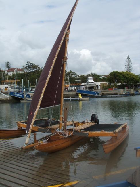

Hi everyone,attached are some photos of my Polynesian style trimaran.It was designed by my brother and he had built the hulls from 19mm x 3mm double layer strip planking (Kwila) and sheathed it inside and out with fibreglass.he had almost finished teh hulls before he became too ill to finish it off and asked me if i wanted it.I designed the beams and rigging etc so that it represented a polynesian style of trimaran.It has a bamboo mast and yardarm and bamboo seating etc.It sails beautifully with only 1 sheet controlling the sail.as it only has the lateen rig, it is somewhat limited in its speed potential at present as i am getting about 8 knots in 15 knots of breeze, but a few times when i was in 20knots of breeze, it was hang on as it really took off and i was too busy concentrating to look at the speed log.I have taught myself to sail with this tri and have recently bought a Mac 26D which we absolutely love, but this boat will always remain my favourite as it is a reminder of my brother. He passed away before he was ever able to come out for a sail with me, but at least saw the finished boat and absolutely loved the finish i achieved.
