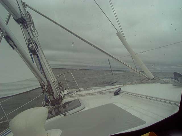

Yes a dodger is a must if you enjoy sailing in all kinds of weather. Picture is Monday, May 26 on the Potomac River. A beautiful rain filled day with winds in the 18-20 kts. First mate came up just after this asked if we could reduce some sail, she was having problems standing up down below. Jim S/V Java

Nice photo Jim
Looks like you were hiding under the dodger taking this photo!
