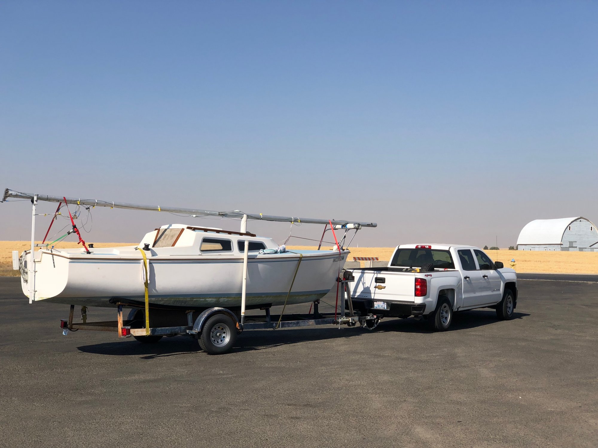

How wobbly is your boat on the trailer? Mine is pretty dang wobbly. Makes me wonder if this is the proper trailer for this boat. Or maybe I need to see if I can stiffen up the trailer somehow.

You might need to help us define wobbly. My '73 is tight to the bunks-- strapped by 2000LB cargo straps that ensure the boat is in close and snug to the bunks-- one across the cockpit just forward of the primary winches and one forward of the raised section of the foredeck. Keel is slack from the winch but resting snug on the keel stop-- bow eye connected and tight to the trailer winch (in my case a strap winch).
Boat and trailer should act as one unit-- wobbly would not be an acceptable scenario for my taste.

Thanks for that @pclarksurf - I put the 2 cargo straps back on and voila!! no more wobble :) :)
