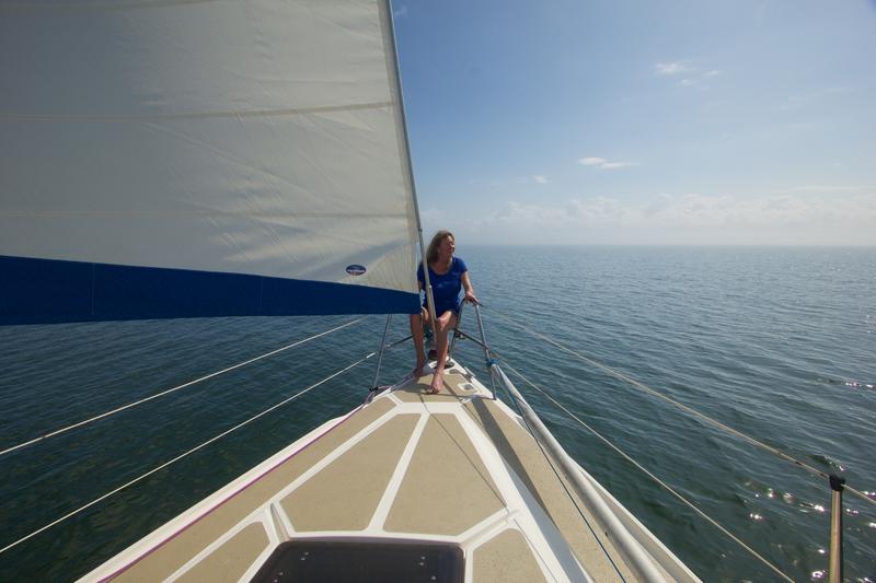

FWIW I have an '83 Hunter 31. My gelcoat was going and gone in places. I painted the entire top side with single part polyurethane paint (Brightside by Interlux) that was three years ago and I have been very pleased with the results. I used the paint with their non skid polymers on the non-skid. Great traction, once it's changed to paint it is super easy to touch up or add a coat. If your gelcoat is still good there may be some better options.
