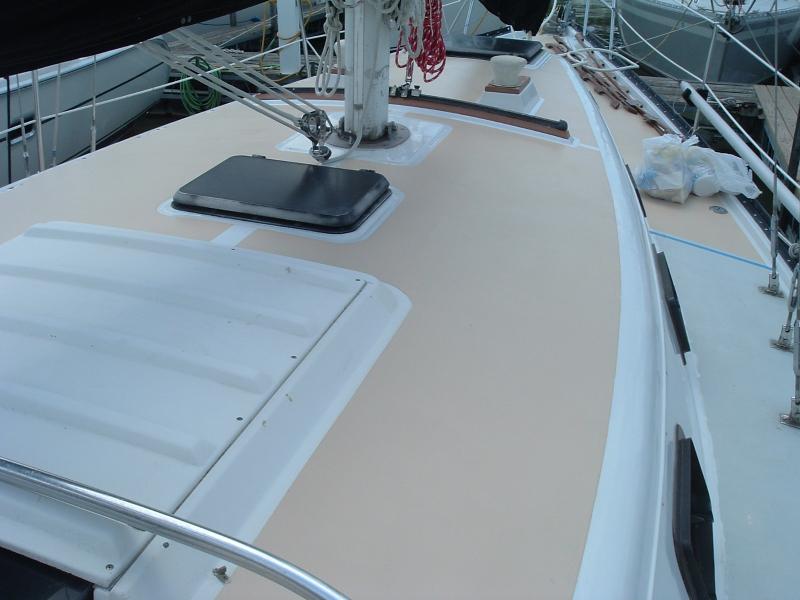

I also have been using Interdeck and am very satisfied. Tried to roll and then tip but if you apply it at what I believe is the right consistency it will not roll well. And the roller will soak up a lot of good paint. So just brush it on with two relatively stiff bristle brushes, one large and a small one for corners and tight spots. No brush marks will be visible so long as you work steadily and keep a wet edge.
About that wet edge. Notice in the picture that I split the boat down the middle with a white three-inch stripe. That allows me to work half of the cabin top at a time.
