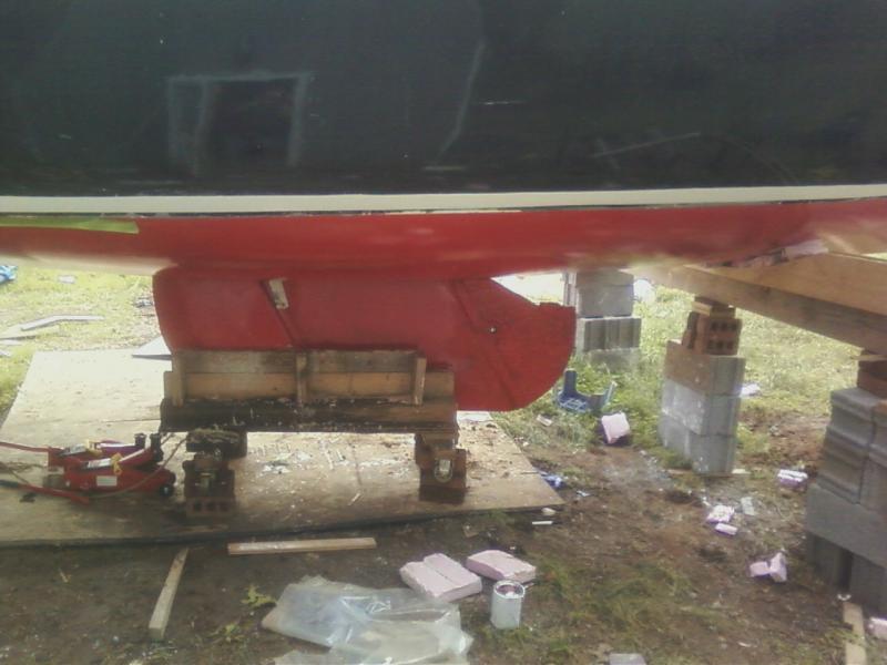

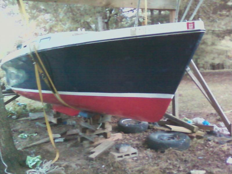

2) Color Match for touch ups!!!! Another reason I love Rustoleum. Here are some pics of some boot straps I've painted with Rustoleum.
These are actually two different boats.... I just used the same color scheme on both because I had the paint already.
In the first one, I was still tapping in prep for a thin blue line between the bottom and the white boot stripe. The thin blue I did with Rustoleum Marine "top side" paint. It really came out well.
