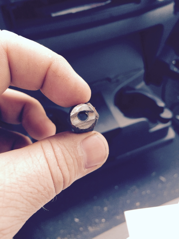

Catalina 30 Rockport, TX
This is the water injection nipple from the mixing elbow the PO made. I'd say this would cause the high temp. Specs call for a 5/8", this is less the. 1/4"! I am going to rebuild the entire exhaust system.
23,360
Good idea. Have you considered a new prefabricated exhaust riser from Catalina Direct? Their pricing is high, since they separated the costs of the metal and the insulation, and I've heard (man, I hate that phrase but I read it right here!) that they won't sell the metal without the insulation), but I don't know what your plumbing skills are.
Our C34 manuals have a good sketch of the exhaust systems, so I suppose the C30 manual would as well.
