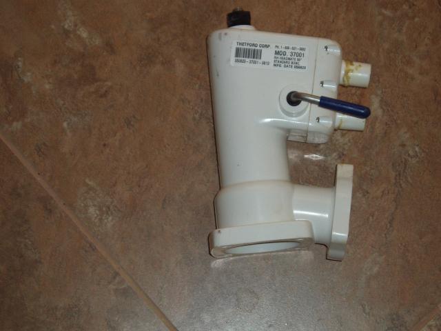

Keep trying, Seadaddler...you'll eventually find a taker for that Headmate pump!:dance:
