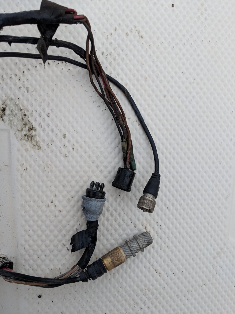

If you have a deck socket into which the wires from the mast plug, see if you have voltage at that plug when the switches are on. If not, check fuses. If you do, check bulbs and voltage at the top of the mast. If your mast is down and you can't plug the mast wires into the deck socket, use a 12v battery or find a power brick for some device that outputs 12v DC and use that attached to the mast base wires. You may have to cut the plug from the end of the brick wires or make some sort of adapter to wires with alligator clips. I made one of these so I can test the anchor bulb before I step the mast on my 23.
