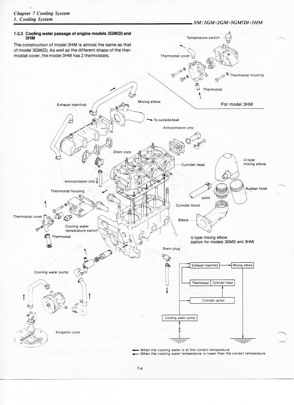

Herrick is correct.. you'll need to disassemble the exhaust ell and clear it.. if one hose was clogged, (not sure which hose is outflow?) then ya probably have a clogged water inlet to the exhaust ell. You could check that by pulling the hose end that goes to the ell and blowing into it, toward the ell . The problem with flushing is that you need a fair flow to be able to accomplish anything.. without a flow established, ya can't flush.
Attached is a flow diagram of a raw water cooled 3HM cooling system
