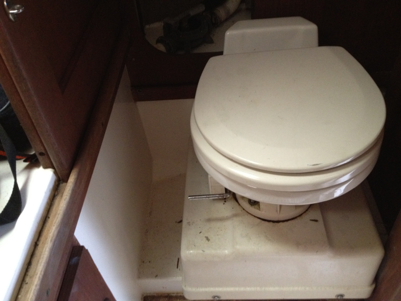

Is the overboard discharge thru-hull below or above the water line? Does the head/holding tank setup have one or two manual pumps?

Does it kinda look like this ? How far are you from the 3 mile limit ? Maybe just go out and make sure it's empty?

It looks very similar to the above picture.. The holding area may be a little larger to accomodate the pump which would be elevated behind the lever. It discharges above the water line. Sorry no photos yet.. I didn't make it down to the boat this weekend.
Unfortunately it would take me several days to hit the 3 mile limit. I'm thinking my only real option is to pump it into a bucket and dump it into the waste disposal station at the marina.

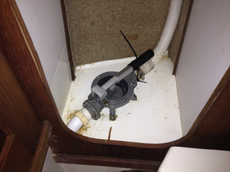

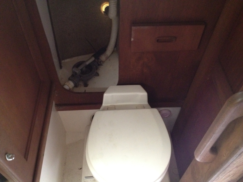

Here are the photos of the looming job.
I have confirmed there are no other lines other than overboard.
I think this is going to stink. Bahahaha

So ya have a toilet that drops stuff directly into a holding tank, just like a porta-pottie?? .. then the hand pump will pump whatever is in the tank overboard (once that tie wrap is cut off).. soooo.. you could treat the stuff in there with a bunch of bleech then fill the tank with a hose thru the bowl bottom opening.. Then pump overboard.. .. then refill with water a couple more times and pump overboard.. This may not be legal.. so don't do that if your area is very sensitive.. Another way that would be legal would be to unscrew the pump base .. Remove the hose from the thru-hull fitting and lift the pump so that the end of the hose on the inlet side of the pump (left hand side hose) is higher than the level in the tank.. carefully remove the hose from the pump.. nothing will come out if the end is above the level in the tank.. Then insert the dock side pump out suction into the hose and clear the tank.. rinse the tank with a hose and repeat.. STINKY JOB.. Make sure ya have enough hose slack before even starting.. Then you can pull the whole shooting match out and replace with what ya like.. That system can be made to be OK by putting a T in the hand pump suction line and running a hose from there to a deck pump out fitting .. That way you keep same toilet (don't know if that is good or not) and you can pump out at a regular pump station. The hand pump can remain if you re-tie wrap the handle.. Good Luck
