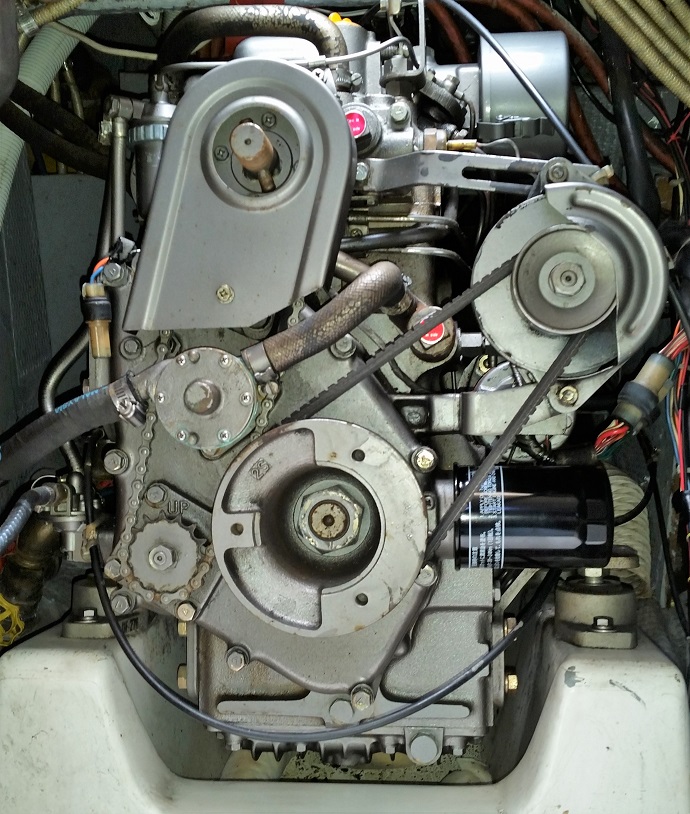

I just sucked out only about 3 Qts of Oil with my Big Boy Topsider hand pump from my Yanmar 2QM20, for my seasonal oil change.
I have 2 Questions;
1- Does anyone know how to get the remaining 1 1/2- 2 qts of oil still in the Crankcase sucked out?
2- I am considering not adding my 3 qts of new oil into crankcase until spring. If I don't plan on starting the engine till Spring, is there any reason to add oil to crankcase now as opposed to waiting for springtime?20160410_132243 (2).jpg

ok, just back from my boat, (and on-board manual) looks like the manual says indeed the Crankcase oil volume in a 2QM20H should be btwn 3.5 qts min. and 5.4 qts max. (dipstick read full just before oil change)
So, I guess there is still over 2 qts of oil remaining in my oil pan...how do I remove this considerable amount of oil?
