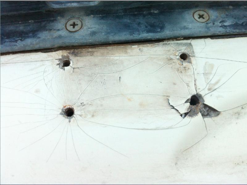

Just pulled the hand rails around the cockpit on my H22. They were a shoty modification by the PO, and were busting loose. Maybe I'll put them back on one day, if I can figure out how to put backing plates in the stern, which they did not have (were only screwed in). So how should I approach the fix? Here is an image of the worst of the damage.
My Plan:
-Clean with Acetone
-Sand
-Fill holes with Marine-tex.
-Sand
-Clean with Acetone
-Apply Evercoat Polyester Gel-Paste
-Sand
Sound about right?
