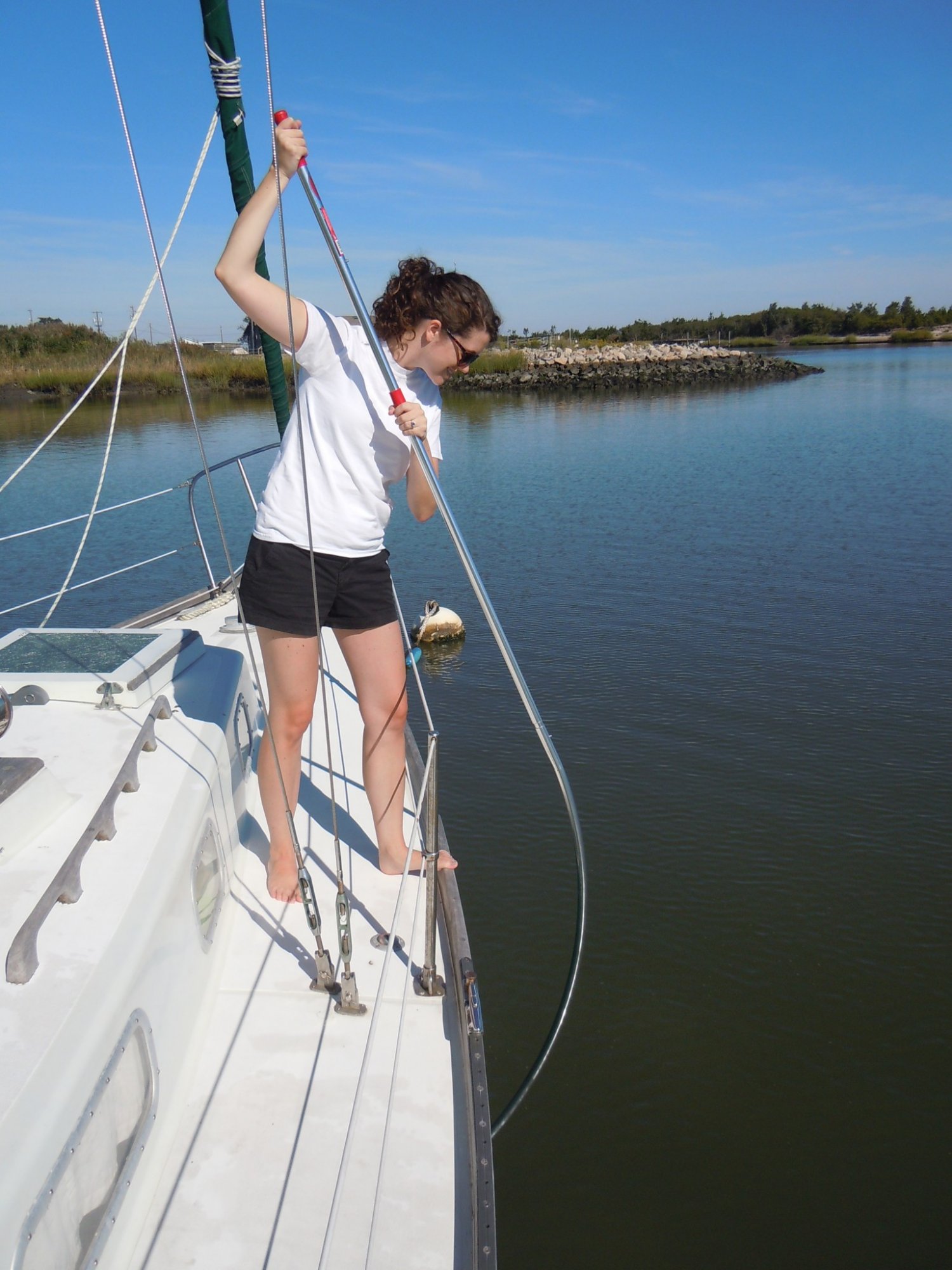

Yup, seems to de discontinued. I have one and sometimes used it for a spring cleaning, before the water warms up. Best with the Groovy head, which was more aggressive. Far more effective on soft growth and slime than you would think, but I guess they did not sell well. I could clean my trimaran (yup, reaching under the tramps) in about 15 minutes. But right now my paint is working really well.
I would use something stiffer, like 3/4" EMT bent with a hickey (not 90 fittings), a float made from one of the fat (5-6") pool noodles (as much flotation as you can reasonably push underwater), and artificial turf. It is the flotation that does the scrubbing (it mostly cleans on the up-stroke IME), so the turf needs to be more on the top.
