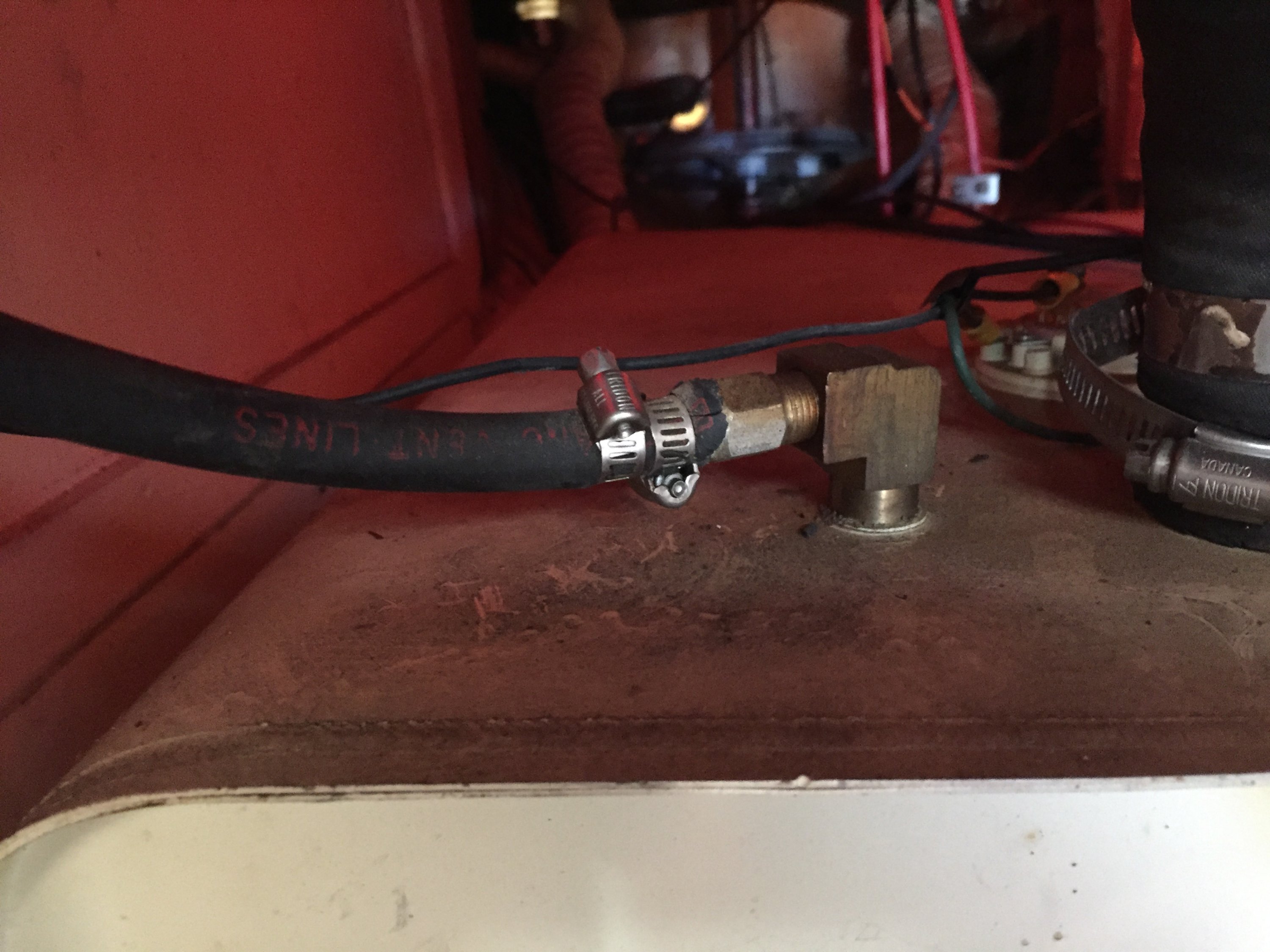

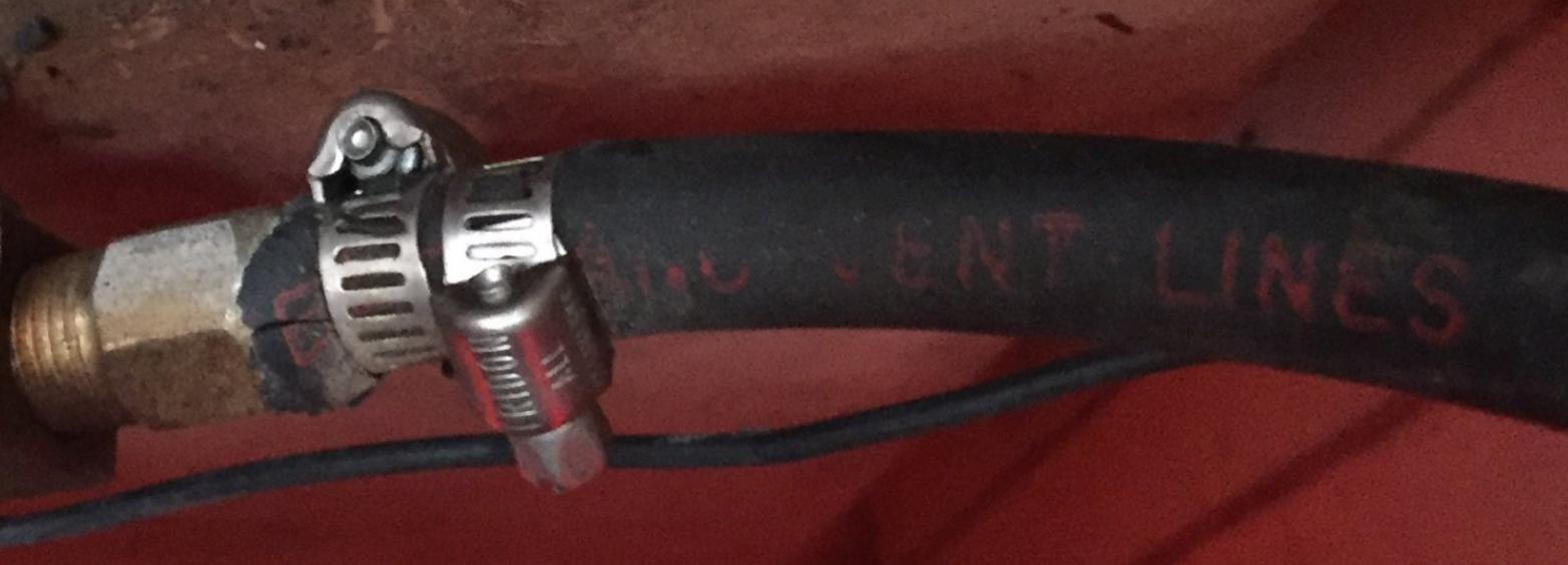

Does that label say "vent lines" or do I have an overactive imagination ?
I also see a crack in the rubber under the upstream gear clamp. If the tank is higher than the engine, you may eventually start pulling air into your fuel system given the brittle condition of the hose.
Air inlet or fuel leak, neither are a welcome thought.

Suncatcher,
In your posted picture there is a loose hose clamp that appears to be around the fuel inlet to your tank. Not a good thing! If you are changing hoses during this filter change be sure to double clamp all connections. If you are not changing hoses check all the clamps for rust or loose fit and check all hoses for cracks, brittle feel, or mushiness.

•I didn't notice the fuel intake clamp. I'll check and tighten that and double clamp it.
•I also didn't notice the 'vent' markings on the hose or the crack. I'll get the correct hose to replace it.
•and I'll check all the other engine hoses
