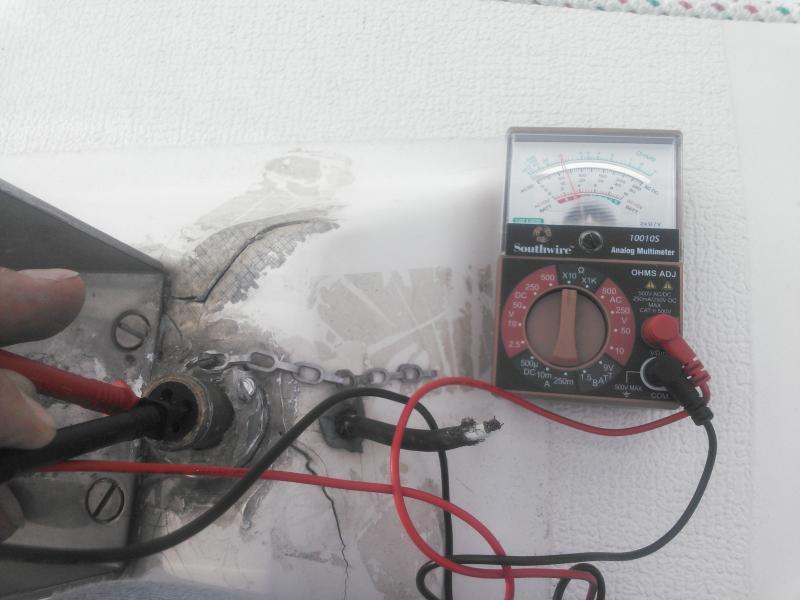

Every spring I put together an extension wire with alligator clips so I can power the mast plug while mast is still horizontal. Steaming light good, no top light . Open up the housing, bulb falls apart in my hand..this is gonna be an easy fix! NOPE, new bulb ,nothing, multimeter at fixture , nothing, pull the male plug apart at bottom of mast, wiggle, tighten, fidget, nothing. Power is good at decktop female despite how ugly it is in the photos.So..sitting on my pickup bed, under the end of the mast sticking out over the bow..Hmm.

Now the question: While poking around the deck plug with the multimeter, I established that the largest of the 4 prongs on the plug is the ground, with one hot for steaming light, one hot for anchor light and one unused. This is consistent with the information I have from Precision about the electric system.
What confuses me is that when I had the meter on ohms to check continuity, I had meter reading between the ground and all 3 of the other holes , even the unused one, this with all switches off inside. Does this indicate trouble or a short in the deck top plug?
