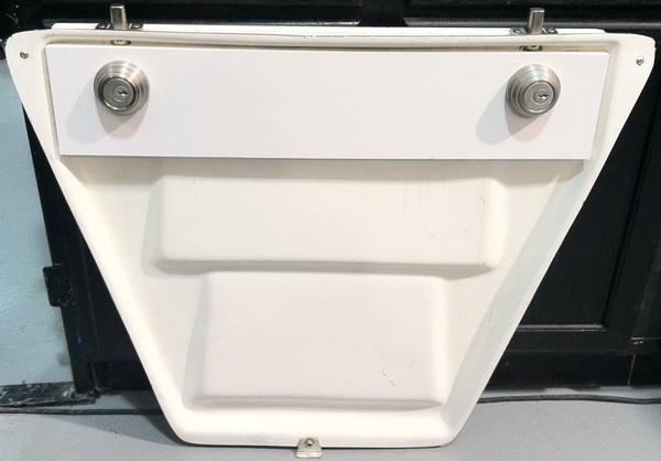

I built this for my Mac 25 because the hasp (gate Latch) was made out of zinc, put on wrong, and bent to make it work. To hide the holes on the material, I added to the structure. Two locks was to give it strength to hold materials on both sides, more so than to lock up the boat. This locks from outside or inside.
I cannot do this to my 32 Aft Cabin as I am trying to make her all original. Her SS hasps are installed correctly.

Oct 6, 2011
678
CM 32 USA
Bill Roosa said:
Please consider the need to leave the vessel quickly. the last thing you want with a boat fire is to be trapped below because the keys to the door are in your pants in the room that is on fire.
It is key locked on the outside and not key locked on the inside, like a typical dead bolt on a house. Very easy to lock and unlock inside without a key. I have lock smithing experience. If anyone were to want to do this to their boat, show this photo to your locksmith. It is a job to install a deadbolt on an undrilled door, but it is art to do the same thing to a boat entryway and have everything look good afterwards. I would do it again to a boat I was not restoring to original, but it does involve specialty tools, experience and some head scratching.

Oct 6, 2011
678
CM 32 USA
Mike H. said:
Stay somewhere where you're safe. Locking yourself in is dangerous.
Is the easy opening from the inside deadbolts on your house dangerous? Something must be getting lost in communication, nothing dangerous. Lol
