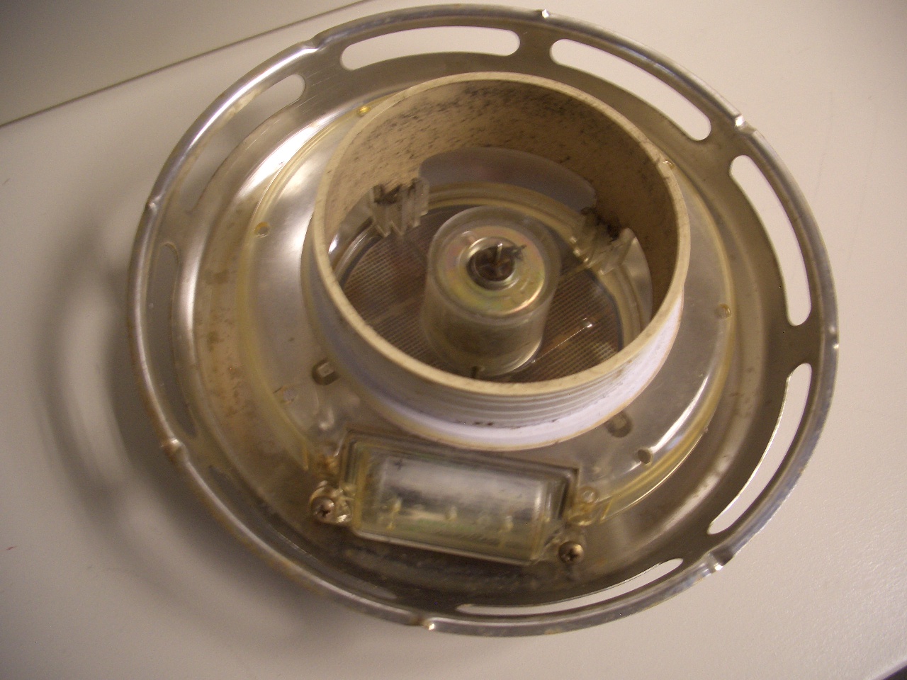

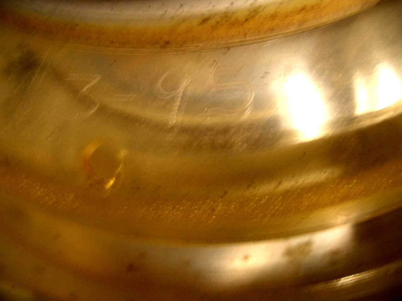

Finally got this off the boat. It shows a 3/95 date scratched into the plastic housing. Anyone have a contact email or phone for Nicro or whomever took over for them? Need to find out if this old guy is even repairable/refurbish-able. Motor shaft seems to spin freely.

I unscrewed the top (the 4 screws you see above) and frankly do not see a way to get at the motor without breaking the plastic casing around it. Anyone know if this vintage is really repairable, even with a "hack" approach?
12,707
It was assembled at some point so you must be able to disassemble. What does it look like inside the boat? Maybe you have to pull the vent completely off of the boat to find the access points.
If you get this figured out please pass along your solution. I have the same fans, probably from the same year. One works fine and one only spins if you start it with your finger, and then it is slow. I replaced the battery and had the same problem so I'm thinking it is the motor but couldn't see how to get it out without breaking the case. I got as far as you have and then just put it back together.

You probably can on that one but the 1995 vintage is a way different model. It looks like the motor was cast or glued into a clear casing and I just don't see how it could come apart to replace it.
The model on my boat is a little newer than yours. Once the screws are removed, I was able to pry the solar cell up and out of the metal dome. It's held in place with a rubber gasket to keep the moisture out. The motor is then accessible under the solar cell.
Look like yours is an older model similar to the one in this post:
Nicro Marine Solar Day/Night vent
You may have to cut the bottom portion of the tube the motor sits in and glue the replacement in place with some sikaflex or similar.
