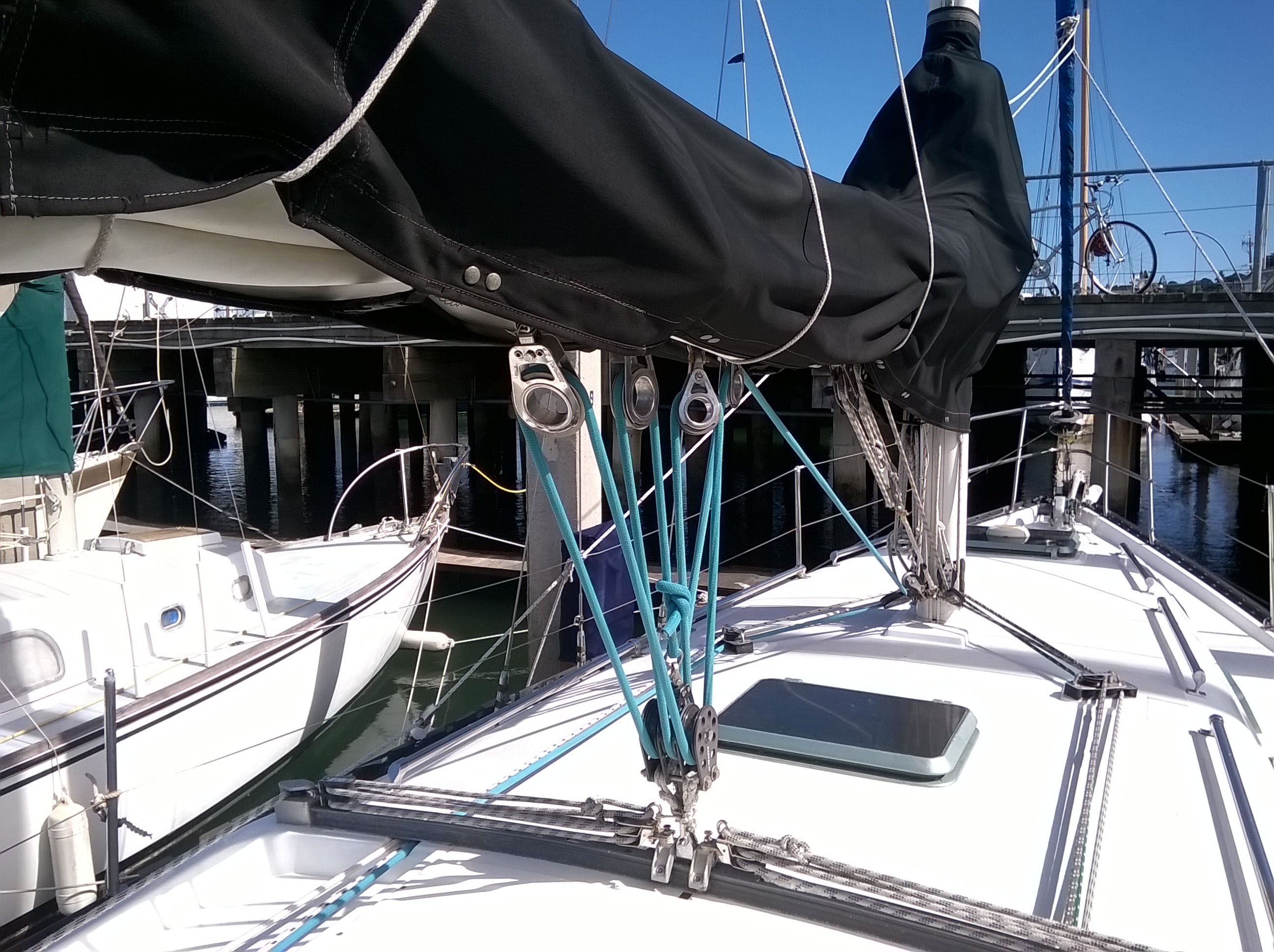

As background, I also was dissatisfied with the performance. By chance, several years ago at a local nautical flea market I encountered upon a brand new, never used car. (The seller only wanted $10 for it!). I installed and also modified the blocks at both the traveler and the end stops to achieve greater purchase than before. I now have 5:1 on both the port and starboard sides. (Photo attached.)
The result of the two mods: Still underwhelming. Takes tremendous effort to move the traveler upwind when the sheet is tight and the wind is stiff. ... If it can be done at all.
I think the main issue with the original design is that the rail and the car bearing is a compromise. Oriented at ~45 degrees. Up-pressure when the boom is sheeted tight and in a stiff breeze is too much to overcome the friction of the delron bushing.
Compare to newer designs that have ball bearings 100% vertically up against the rail.

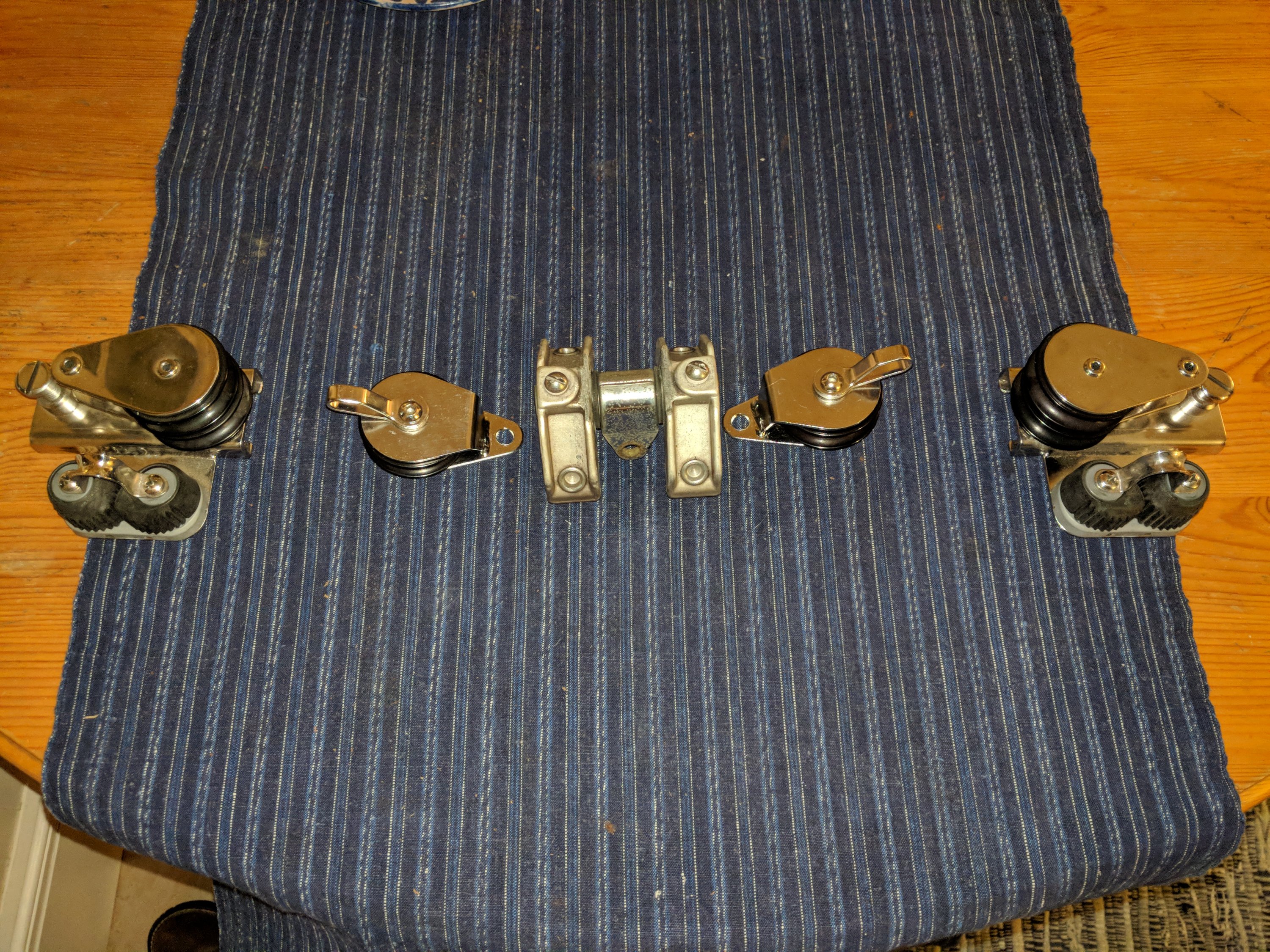

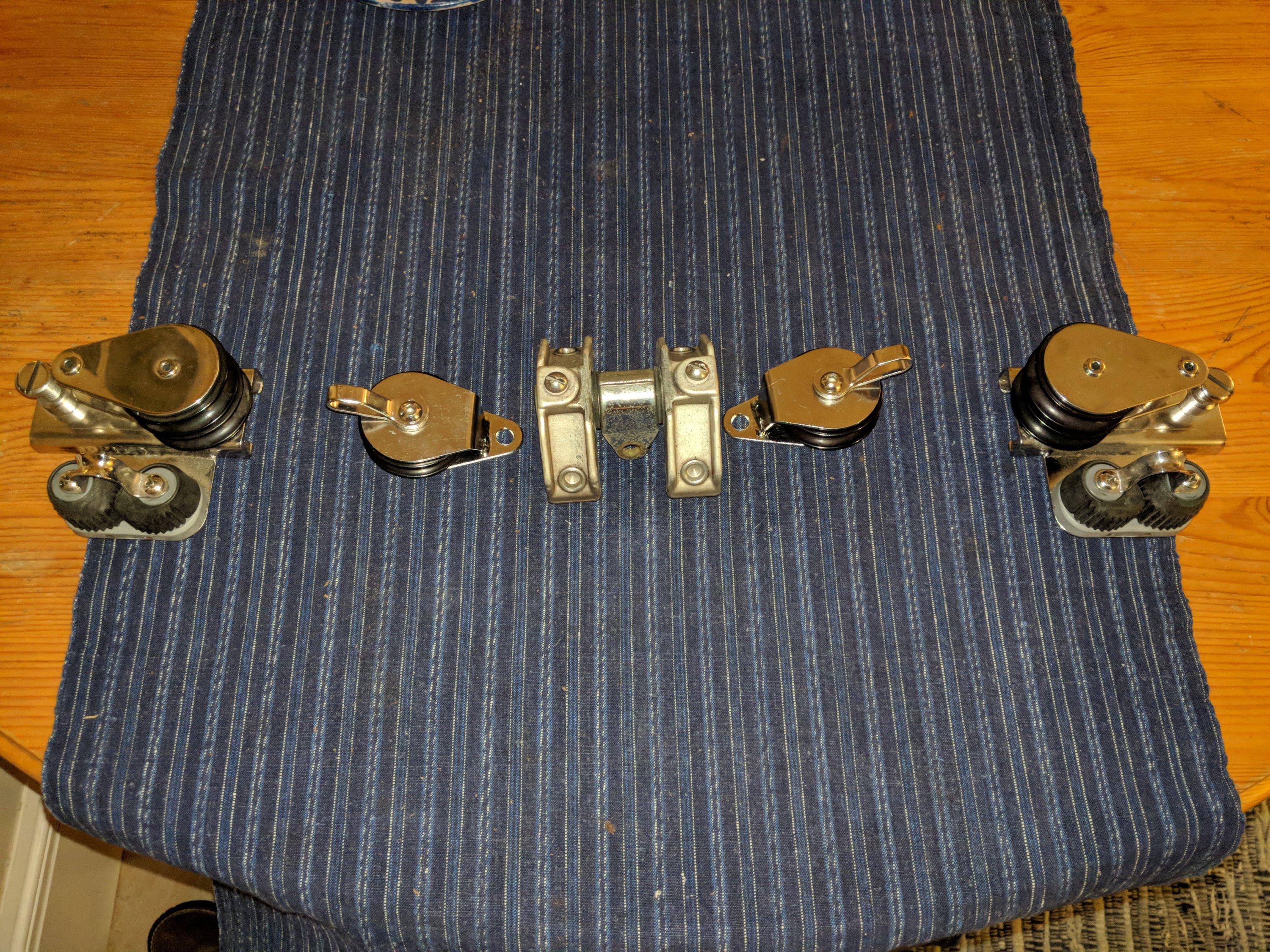

Thanks for all your advice in this thread, I contacted Guido @ Garhauer, ordered the control cars, I got them last week and I am thrilled. Even more importantly Guido made me look like a genius in the admirals eyes! Main sail control will be a breeze this coming season....after we get those round head machine screws out of the center car that is.

Thanks for all your advice in this thread, I contacted Guido @ Garhauer, ordered the control cars, I got them last week and I am thrilled. Even more importantly Guido made me look like a genius in the admirals eyes! Main sail control will be a breeze this coming season....after we get those round head machine screws out of the center car that is. View attachment 147548
That's pretty much what I got from Garhauer a few years ago. You, and the admiral, are going to love it.
Use Kroil for those machine screws.
