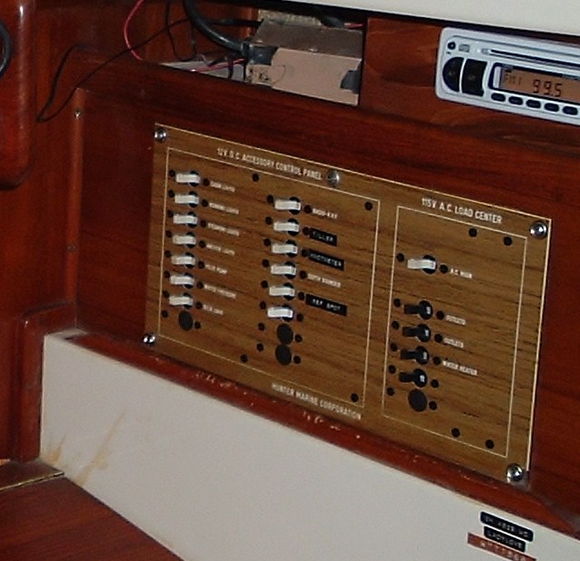

A couple of years ago when trying to rewire my OEM electrical panel (the faux formica wood grain type I've also seen on-line many times as OEM standard for Cherubini Hunters) the original embossed panel labels no longer matched up with the switch functions. The attached picture shows the outcome of how I got around this. I think the result is pretty good. See the attached pic. Sorry about the picture quality -- taken with my Blackberry rather than a real camera.
Method: At my local stationer store, I found some tan/brown project cardboard that matched the panel's wood grain color. Also I bought a white ink pen. Lightly with a normal pencil I drew lines so I could free-hand block print about the same size as the lettering on the original panel. Then also with the pencil I carefully drew block letters that best I could matched the panel's type face. I traced over these with the white pen. A couple of times were necessary to achieve a bright white. Using an Exacto type knife/cutter, the new labels were cut from the larger cardboard piece. I then sprayed them with clear lacquer to "plasticize" the cardboard and make the white print resistant to moisture and possible damage of the years. Several coats and on both sides. Finally, the new labels were affixed to the panel with double sided tape.
