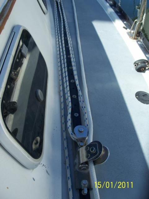

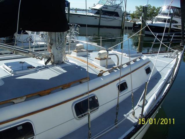

I changed all of Midnight Suns ports and hatches with Lewmar aluminum ones in 1994. The large ports open out. All the hatches were drop in. (size wise) The large ports were smaller than the Grey ports so the holes had to be made smaller. A big job, but worth it. You can see a couple of my ports in the photos that Ed posted on the traveller thread.
