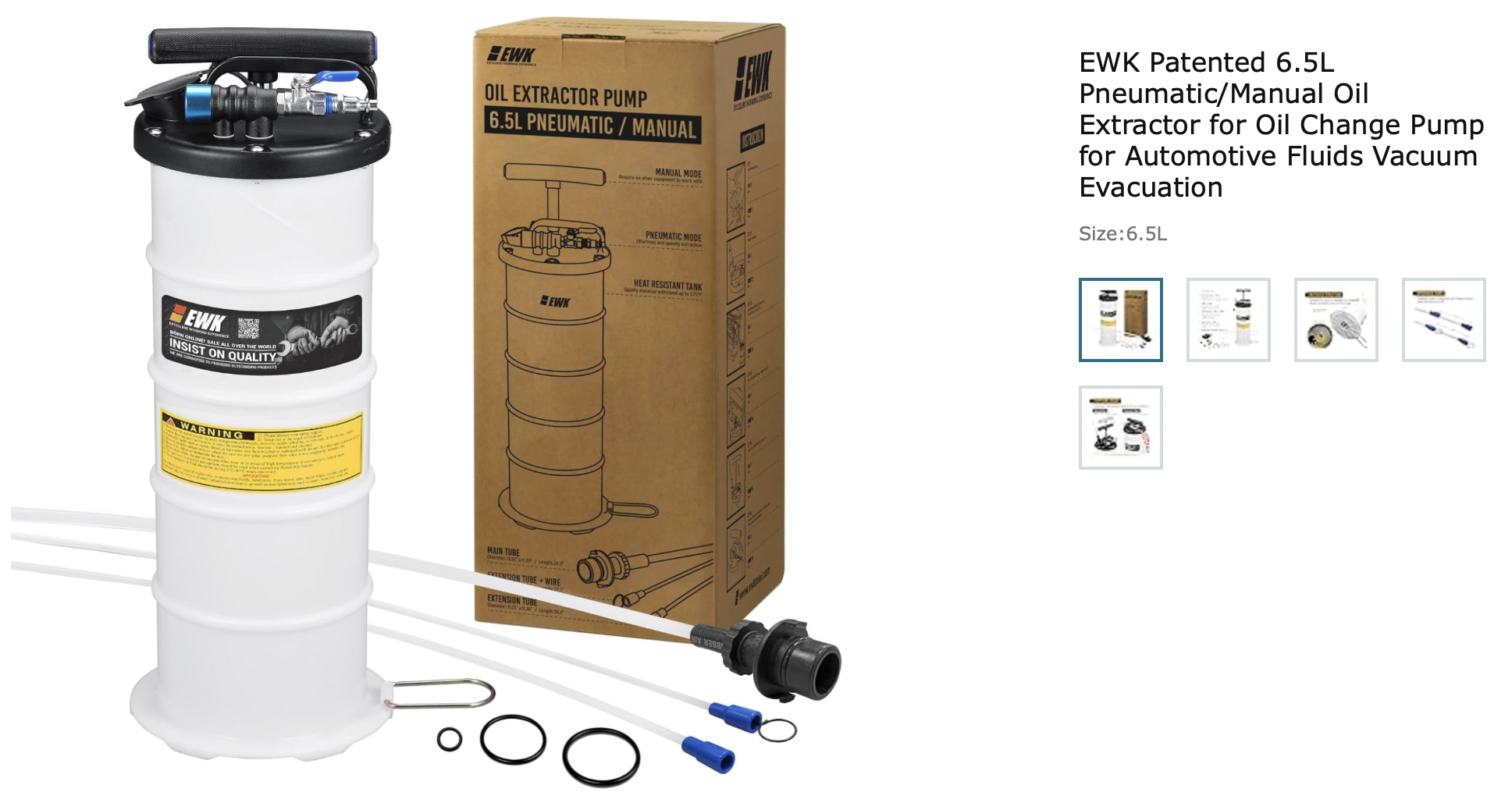

1. I assume I have to hand pump out the old fluid and would love a suggestion on which pump to buy.
Yes. I bought one like this. Use it to extract all oils from the engine. Works sweet. Will work for your transmission. Different hoses used for different oils. Avoids contamination but not critical. There are others smaller for smaller engines. Be sure to check your engine to get the right size. No fun making two trips to the oil dump when you can make one.

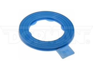

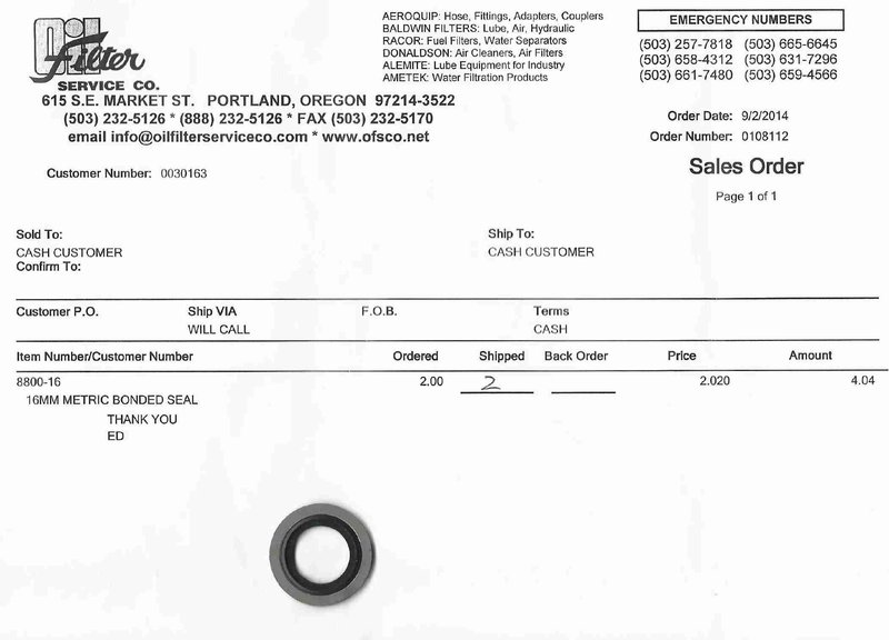

Thanks for the good advice, Richard. When you say replace the washer, where is that washer and is it rubber? (Haven't been able to give it a look, because rain and some high winds have made working on the boat engine near impossible, but maybe Friday, so I am not sure yet if I have room to remove a plug, or if I have to pump.)
The washer goes on the fill and drain plugs.
I used something like this but I can't remember the exact size, either 14 or 16. It's the same size diameter as the fill plug though so you can take that out and measure it. You'll want a new one for the fill plug anyway.
edit: On further look I think the washer is the 16mm size.
