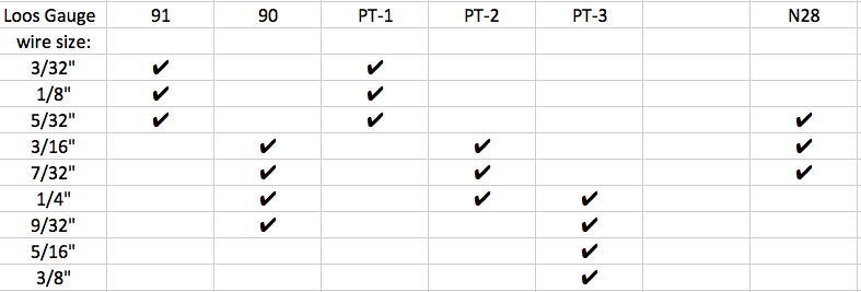

Probably so. But which one? Are all the Loos gauges calibrated to the same numerical scale? I assumed the scale was arbitrary, per the particular gauge. I have the PT-3, and while there's a "18" on the scale, for example, it doesn't correspond to anything for 3/16" wire.
Nov 8, 2010
11,386
A PT-3 is too big for 3/16 wire. A PT-2 would probably be right.

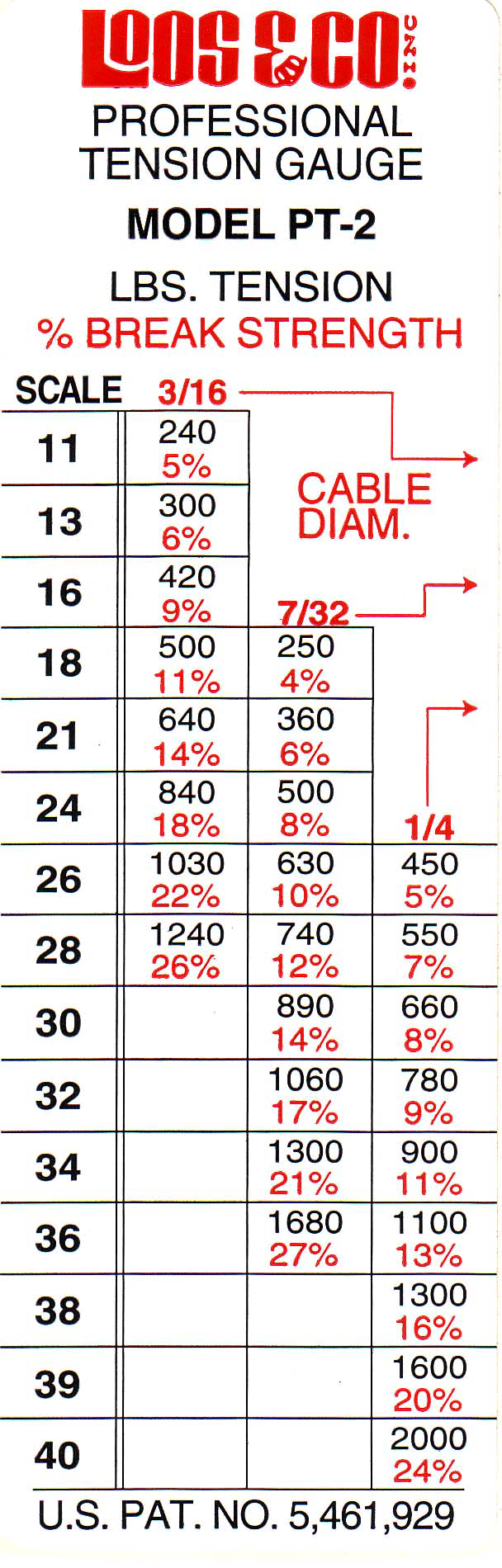

Well, 16 on a Loos PT-2 directly reads to 9% of 3/16 wire breaking strength.
Just to calibrate, I have a PT-3, which doesn't go down to 3/16"; what does "16" mean for 1/4" on yours? For mine it's 18.5% (using linear interpolation; my table doesn't list 16, it goes 7, 10, 15, 17, 19, 22, and so on).

I got a chance to put my Loos PT-2 gauge to use over the weekend. I did not take any measurements on the aft stay as I could not get a useable reading on the 5/32 wires. So with that said, here are the number that I measured.
Forestay 7/32--18--250lbs--4%
starboard and port fore shrouds 3/16--14--360lbs--8%
starboard and port aft shrouds 3/16 16--420lbs--9%
starboard and port cap shrouds 7/32--21--360lbs--6%
Not sure the readings really have any meaning. The important thing is that the shrouds all measure the same on both sides. so at least it has even tension.
