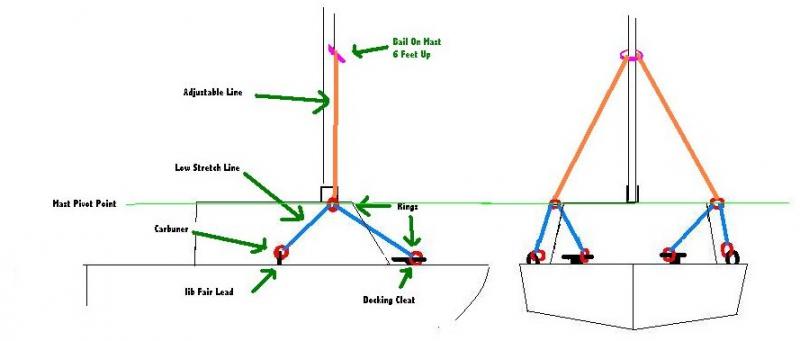

Your boat has side deck cleats near the front of the cabin on the side decks.
Those are good attachment points for one leg of a baby stay harness.
Our harnesses are like inverted V's when attached and then the baby stays attach to those inverted V's. I don't see a good place to hook a rear leg for an inverted V on your boat.
The inverted V makes it possible to raise a baby stay attachment/pivot point up to the level of the mast foot. This will allow baby stays to stay tight while the mast is being raised and lowered.
Attached is a diagram showing how it might be done - but there are lots of ways to skin a baby stay...

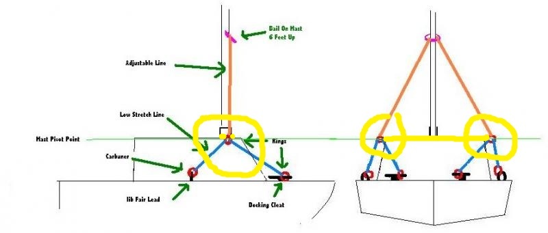

So as long as the area circled in yellow lines up with the pivot point of the mast, things should be good, right?
To answer your question - YES.
The blue line on the diagram indicates such.
