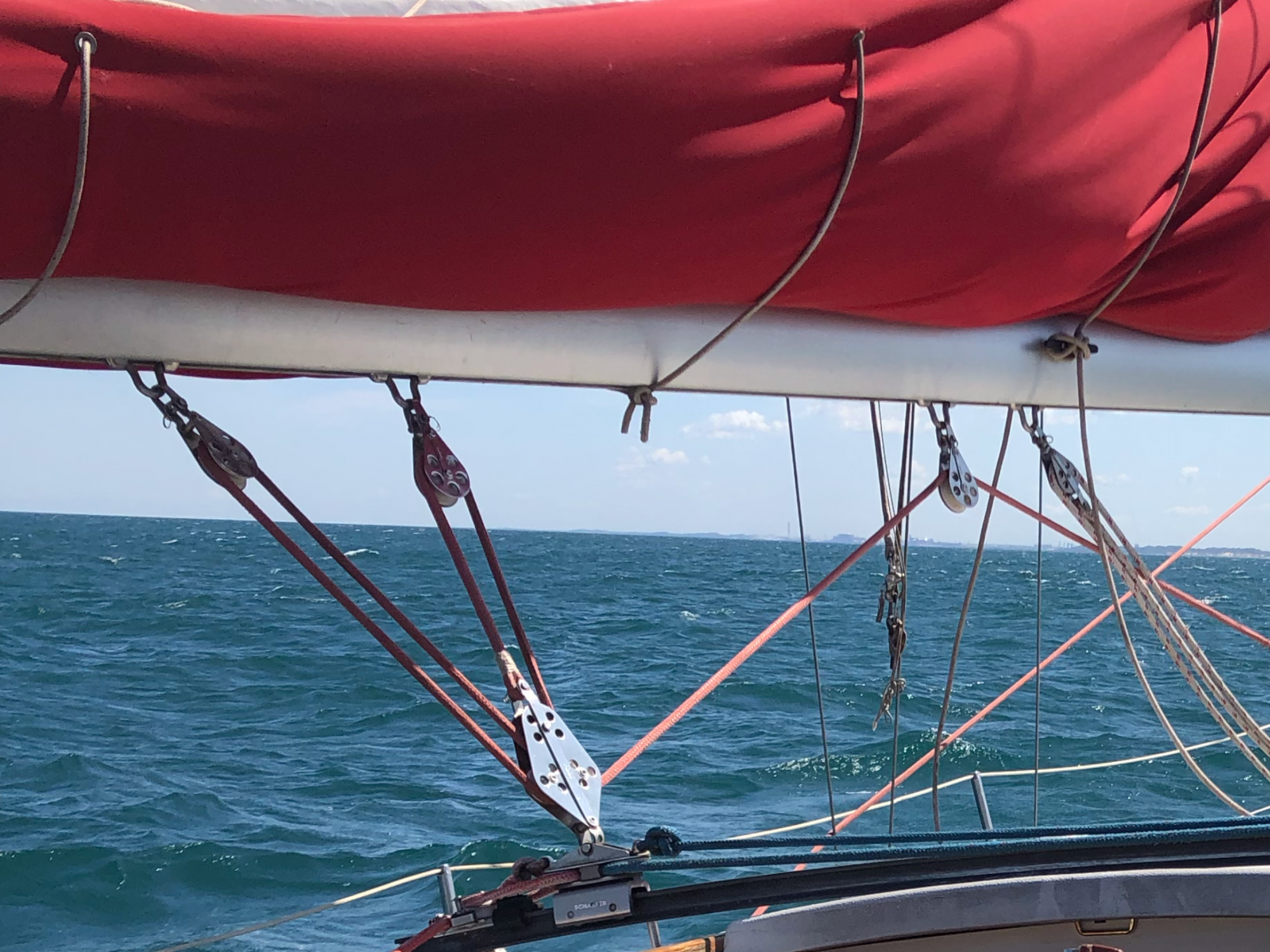

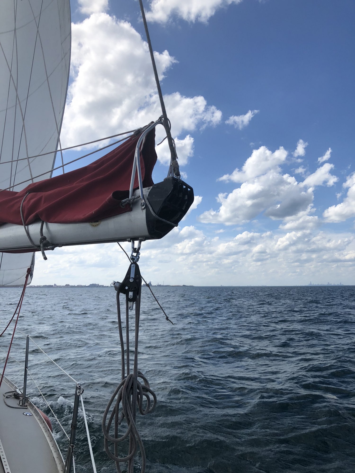

The first thing you describe sounds like either the mainsheet or the boom vang...probably the vang.
It would look something like this...
in this photo of my boat, you can see the mainsheet (red line) and the gang (white line on right side of photo.
So which one does your look like?

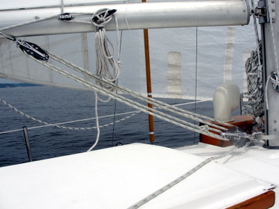

The other thing may just be a way to keep the boom steady when not in use. I use something similar, and have it attached to the toe rail and the boom pulled way over so I don’t hit my head when climbing out the companionway.
Here is mine when the main sail was not in use...
